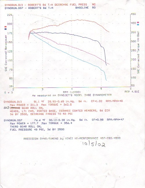

i ported the stock base for my engine. and i still gained torque at the bottom. i'm up to 362.9rwtq @ 2700 right now.

Old Oct 29, 2002 | 07:37 PM
tpi_roc's Avatar
Joined: Aug 2001
Posts: 2,747
From: Orygun
ported or siamesed?
Old Oct 29, 2002 | 07:39 PM
mrr23's Avatar
Posts: 1,392
From: orlando, fl usa
Car: 1986 pontiac TA
Engine: 360 HSR
Transmission: 700r4 3300 yank converter
Axle/Gears: 3.27 9 bolt
well siamesed to be exact. here's a pic. now all i need to do is get rid of the stock runners. get some SLP and completely siamese them.

how much more rpm would your motor turn after porting your intake?
Old Oct 29, 2002 | 09:46 PM
mrr23's Avatar
Posts: 1,392
Engine: 360 HSR
you can see by the dyno that it started picking up at the 3500 mark. but, because of the stock runners still on it, it still peaked at 4400 rpm. also the l98 heads i ported. so my next step to increase rpms is to get some SLP or AS&M runners and completely siamese them.
