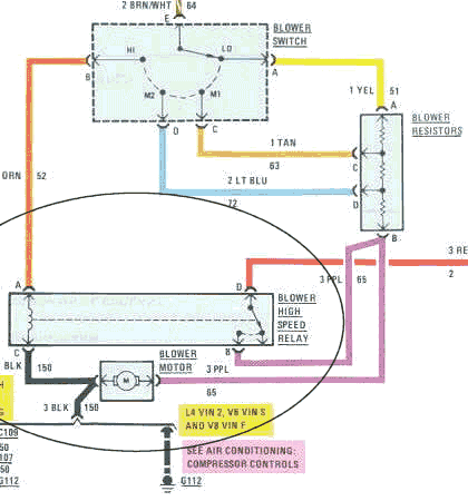

There is a blower high speed relay.
Attached Thumbnails Help!!! Heater continues to run with car shut off!!!!-blower.gif
