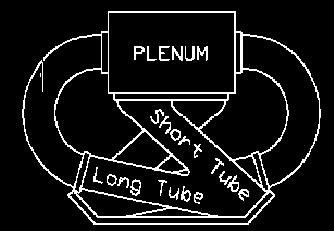

the "second plenum area" would become a vacuum and turbulent spot

The "secoind plenum area" would slow down the velocity of incoming air, create an anormous amount of turbulence, and would heat up the incoming air. It would accomplish nothing; just make the car perform worse. Also it’s not easy to weld aluminum.

I thought about doing an intake like that a while back. OK, it wasn't my idea, but somebody i know managed to cut a big hole in the bottom of the runnners while siamesing a stock base, and thus the brainstorming went from there.
Dunno how it would work or not though. Maybe it would work. Maybe it wouldn't. Unless you've personally tried it, or have extensive experience in manifold design or relevant sciences i don't think theorizing is going to do anyone any good. It definitely could work, so dismissing it as a stupid idea at face value could be foolish.
(BTW, the guy i originally talked with it about had the manifold fixed because he didn't feel like being a guinea pig)

1. A plenum in the lifter valley is not necessarily 'super-heated', it's not going to be any warmer realy than the manifold is normally anyway.
2. If the transitions are cleaned up well, i don't think it is necessarily going to create extreme turbulence either. Think about it, as each runner fires, it is drawing air from the beginning of the siamesed/cut section, which will then pull mostly through the plenum as well as through the runner. And the lower plenum is kept fresh by the other sets of runners as well the whole time. Unlike a siamesed base, this mod would give you a much more effective lower plenum area to draw from. With the couple inches of window it has to pull through, it's not like air has to make some kind of tight bend or anything to make it into the runer from the plenum.
Kaz, i'd especially like to know where you see unbelievable turbulence coming from in that situtation. The runners feeding the base should be sharing the airflow load into the lower plenum pretty equally so there shouldn't be a major collision problem with runner air hitting plenum air as a cylinder draws it's charge. And like i said above, the window from the lower plenum to the runner into the head is plenty large enough that it isn't really a sharp turn to make.
I don't think it'll necessarily work well, but like i said before, i don't think you can write it off either. I don't know of anyone who has tried it yet, so it's kinda hard to guess what would actually happen with it.

Just a WAG, but i don't think the fella meant to do it on purpose, at least when he started. Like i said, the last time i was in this discussion was when someone accidentally went too far on the floor of the runner while siamesing, then the idea kinda hit him.
I wouldn't worry too much about flow benches and trying to measure turbulence and all that. I'd just run it on an engine and see how it does. I doubt it would be a good idea on a stockish engine, but start making some HP and it could do good things, you never know.
I do think the trust GM engineers thing is kinda funny, in the context of their first 2 performance EFI systems were made with looks rather than physics and common sense. CFI is a joke, and TPI is a horrible design all around. Even if you accept the long runner compromise, the whole design of the manifold is flat out wrong. Making the runners do a 180 is just stupid, and the angle of entry from the baseplate into the head is abysmal, way too low, and not even straight. Wanna make a decent functionl long runner intake, take a look at the LS1 manifold for cues. Runners straight shot into the head and only a gentle curve and then opening into the plenum.
Just one more thing to add. Everyone thought simply siamesing the base was pretty crazy and stupid to do, and it's worked out OK enough. And as groundbreaking as it seemed a year or whatever ago here, i've heard whispers that it might have been a secret type mod in some circles going back a little while. Absolutely no reason why the same couldn't be said for doing an intake like that since it would look normal on the engine.

For all out performance, i agree. keeping any type of TPI intake on the car is flat out stupid, nothing abotu the design is smart or conducive to makeing good power.
BUT. A lot of people have to deal with visual inspection, and don't necessarily want to swap intakes every year to get by. Also, if you get a TPI type intake to go fast, then you definitely have one helluva sleeper on your hands. So while a better inatake woudl almsot certainly make more power. If you combine visual inspections, with desiring a sleeper/stockish look, if something like this works better than simple siamesing, then why not.

Its posts like this that make me think alot about the possiblities. And wish that I had the time/money to make custom parts just to see how they perform. Anyways, heres one of the daydreams that I had during some boring class the other day.
What if you took the benefits of the LT1 (short runner), and the TPI (long runner) and combined them ??? I guess thats similar to what the guy was thinking when he hacked up that base. anyways I made a sketch of what I was thinking. What do you guys think?
P.S. Maybe when all this engineering school is over and Im pulling down some real money I can start trying some of these goofy ideas and see what happens.
Hey PK, there are quite a few production cars running an intake like you sketched. I'm pretty sure the DOHC Taurus's run one, and I know there are a bunch of other ones as well. Be intersting to see how it works on a large displacement engine.
As far as the guy whooping LS1's on the street. There are way too many people with fast cars that flat out can't drive. I've seen Z06 drivers running in the 14's before, and that should be a mid-low 12 car right? TPI was great back in the day, and dressed up it looks good. But 15+ years of technology has brought us a long way.
