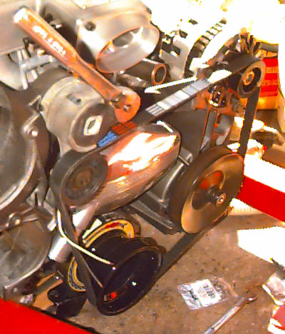

I found this pic on my hardrive. I thought it was an interesting idea, but not sure if it works well. If you don't mind buying an electric w/p it looks kinda cool. You'd still be left with 2 big empty spaces where the a/c comp and air is supposed to be, but maybe that bracket could be cleaned up a little?

TPl383, that's pretty much exactly what i was looking for....
is that yours? do you know what parts or part that is exactly? i would like to do the exact same but again relocate the alternator to the lower half.
lane, i agree with your idea as well accept i don't want to have to depend on an electric pump for a street car....seems to me to many people have problems with that.
thanks for the pictures everyone.....i didn't think something like this would be so difficult. TPI383 do you have any idea what that setup cost roughly?

Here's the website and owner's AIM screen name of that motor (w/ electric water pump)
Website: http://vettel.org/andy/
AOL: A Vettel 77
Old Jan 27, 2003 | 04:23 AM
Sorry thats not mine. But thats what Im gona swap to also.
I can dig you up some PN#'s. from looking at the picture.
The only diff. bracket is the Alt. one.
The PS Pump bracket is a old 87 serp. style one. and looks like all march pullies.
I was just looking at alt. brackets in my summit catalog. Let me grab it again and find a setup for you.

does that bracket mount the alternator up high, or down low beneath the valve cover?

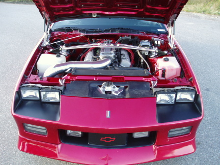

never updated this huh....
well i was in a crunch last year so i had to go with march. very expensive...was it worth it? probably not but they do work well after a year of use and look really good.
i used their sbc kit which relocated the alternator to the oposite side which you can see in the picture. they have low mount if you want.
