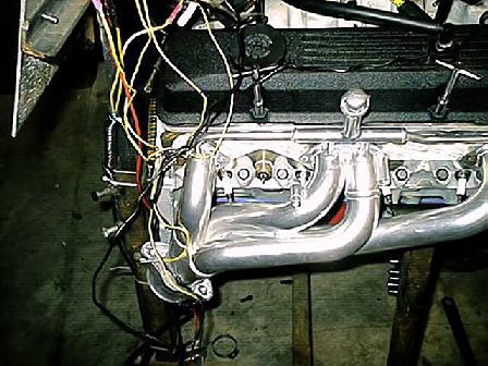

:nono: Notice number 7 & 8 here as the 1.75 SLP's sit on my motor.
These are standard angle plug heads. You must use L98 angle plug heads or go with supercomp longtubes. I learned my lesson the hard way.
