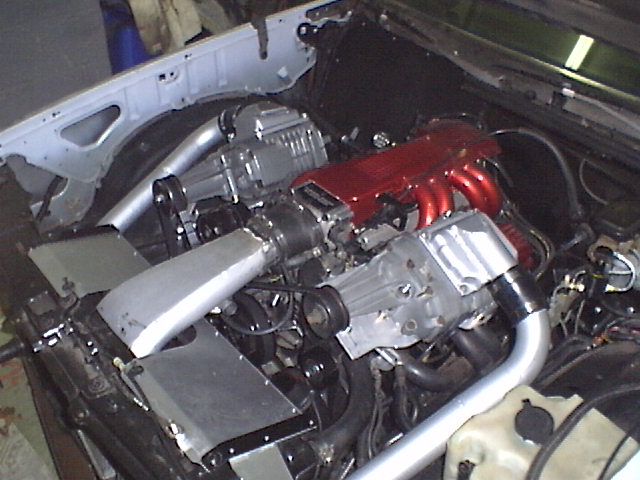

"What would it take to build 275 hp 305 tpi??"
couple of blowers...
