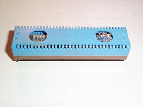

Originally posted by david roush
Mem-cal is the 2 wire connectors that plug into the ECM.
No, the MemCal is the "chip", the long blue part that plugs inside the ECM under its access cover. Your '91 will have 3 harness connectors going to the ECM, but they are NOT the MemCal. And there is no ESC module mounted on the firewall on the '91, it's on the MemCal itself, inside the ECM.
MemCal:
