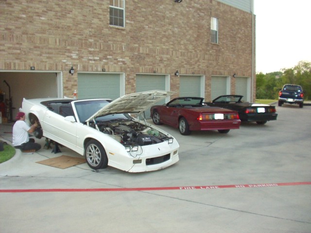

I had a few guys help me swap out my stock pump this last summer.
We dropped the rear and had enough room to pull the tank with the exhaust still attached.
It wasn't pretty but we accomplished what we needed to do.
