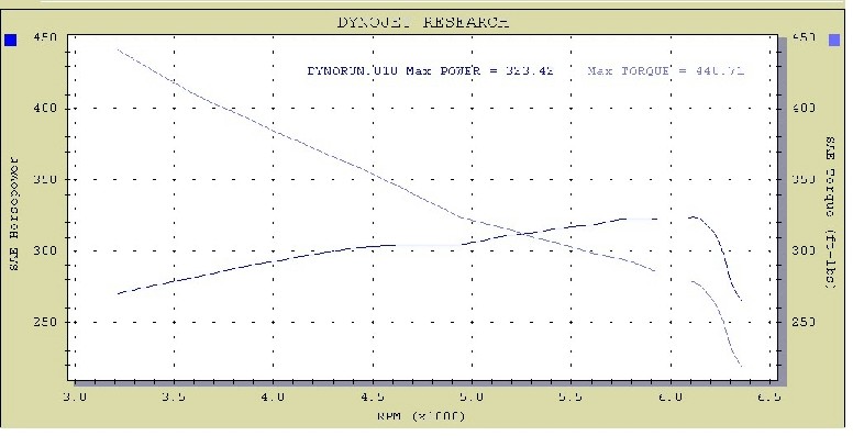

Figured it was capable of good HP, but look at that torque!!! Wow, 410 lb-ft.
May I ask which dart heads were used, comp ratio and cam?

For me:
385, CC 224/230 .535/.544, E-Tec 170, SDPC base, Superram upper, etc...
Dyno results below.
Track results in the link.
Track results...............

For me:
Dyno results below.

OMINOUS_87--thats pretty darn impressive. I've been leaning towards the Superram or LTR. They key for me here is to commit to a direction: either going with LTR/Superram or HSR/Miniram. I'll be doing some searching on 85MIKETPI & check it out, I'm guessing he's using an HSR.
I don't know what to make of the HSR; mrr23 was the car tuned for that dyno run? You have some pretty honkin' heads there & the numbers look lower than I'd expect from such a combo (please do not take offense--none intended--I'm faaar from an expert, just looking to understand the characteristics of this intake). I also woudn't expect power to nose over right after 5000 RPM with the parts you have on that motor. How come you're selling the heads?

yes mike is using a HSR. www.stealthram.com
i've sold the car and everything. right after we got done dynotuning, we unstrapped the car and i went to start it. made lots of knocking noises. so shut it down. though i spun a rod after 300 miles of running it. being so disgusted with the whole ordeal i just got out of it. sold the car and all. well got someone to buy the shortblock. so i went to take the heads off and wouldn't you know it, there was a screw in #4 cylinder. came off the right TB blade. so needless to say i gave up over a .10 screw. i still have the heads up for sale.
