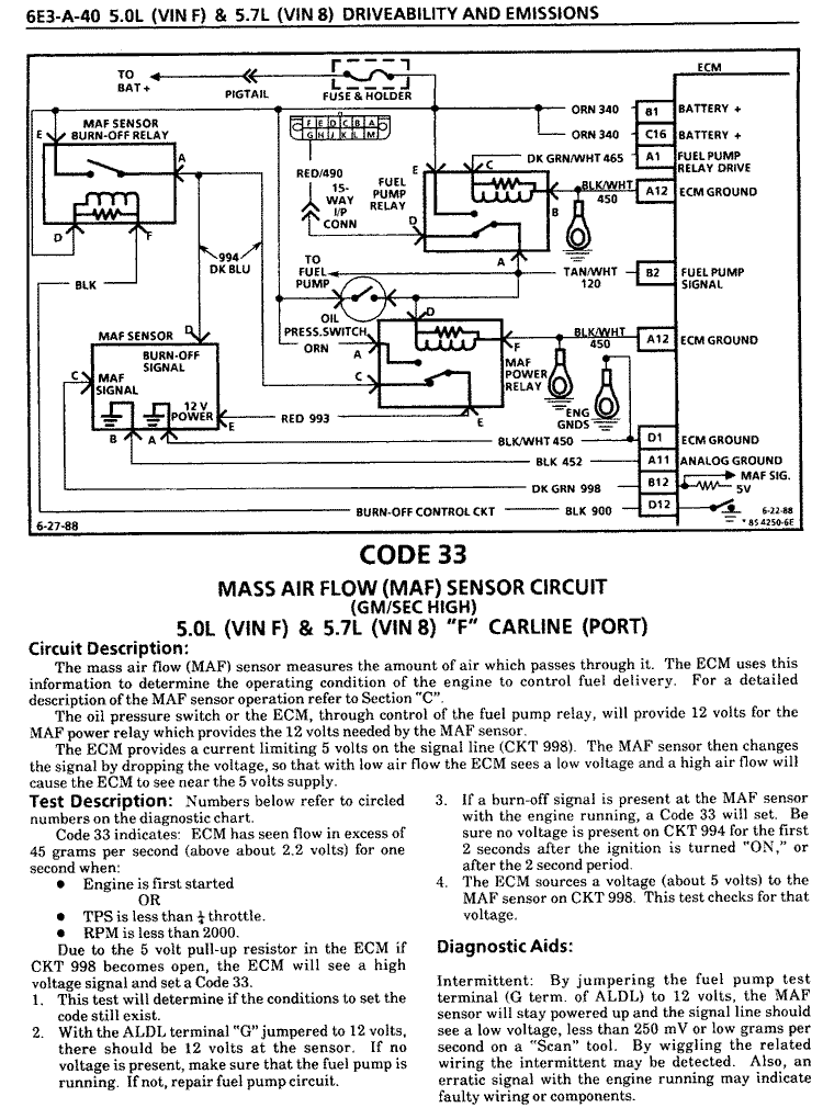

First get the MAF working properly. Here are a few charts courtesy of Trickster. Make sure you follow every step to the letter.

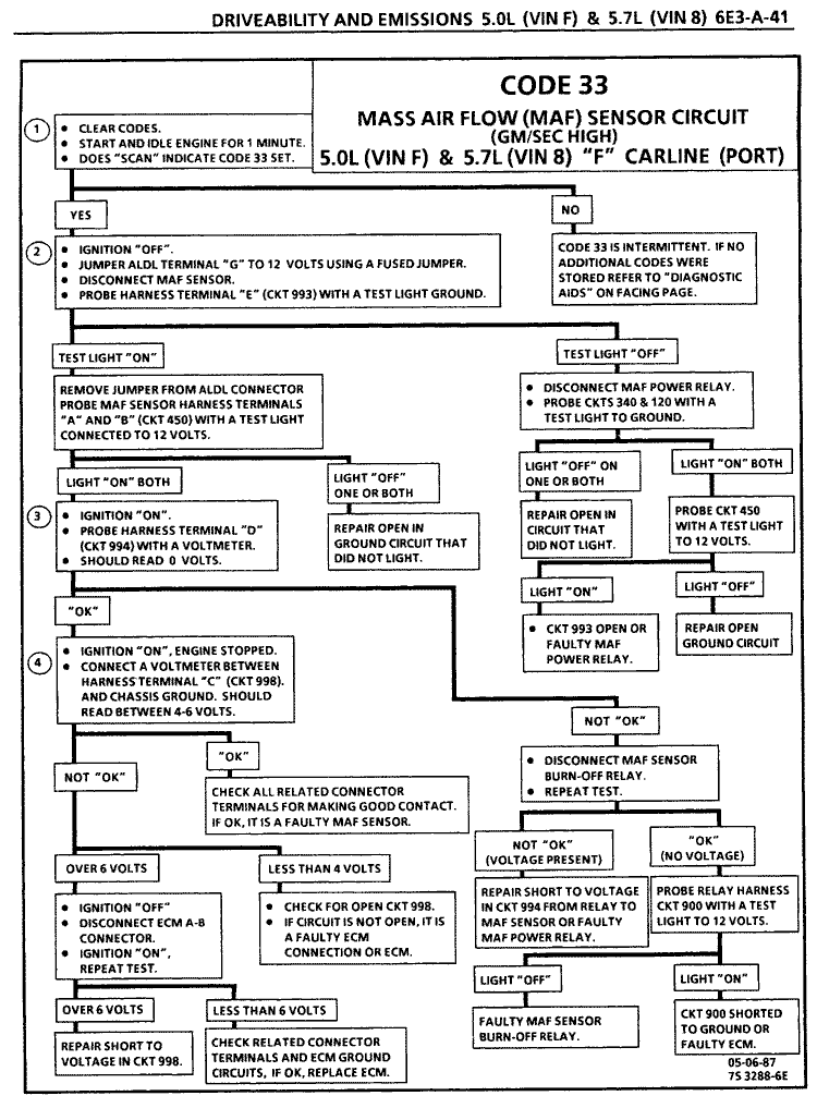

Number 2

I appreciate the help, however we have been through all of those diagrams and everything is working as it is suppose to. We are wondering if something as simple as a clogged cat could be causing the problem. I will be working to see if this is the it, and getting back to ya'll soon. Keep thinking guys, we need all the ideas you can find.
