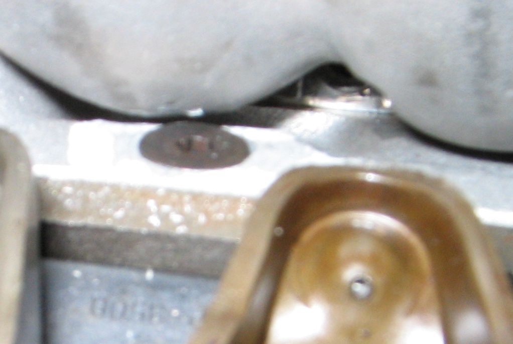

Has any one with the Sdpc combo with a super ram had any runner bolt problems on the intake bolts?
Mine can be cleared out and aligned but Im wondering if I ever take the Sr off in the car is it going to be hard.. As there is lil to work with grinding into the runner and intake to clear the runner curve from intake bolt's etc..

Here is another way to solve the problem:
I took a rotary file and lowered the surface and the used a countersink and a tapered head 5/16" allen head bolt. Now the bolt head is flush. (had to do this on two of them) Walla...problem solved
Look closely at picture again and you will see it.
