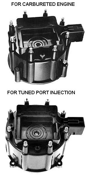

Yes, the early TPIs had a different distributor, with an integraterd ignition coil. Later types had a divorced (separated) ignition coil and smaller cap.
To confuse matters even further, the early TPI engines used a different distributor cap and rotor than other HEI ignitions from GM. The TPI cap is lower and slightly wider:
