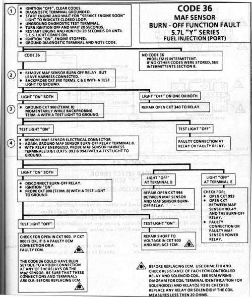

Dont know where your getting your info, but if your sure you have a 165 ECM and a code 36 this is what you should be checking. This is from a factory repair manual.

Old Apr 28, 2005 | 02:05 PM
884+3's Avatar
Joined: Feb 2004
Posts: 225
From: pa
Car: 88 irocz
Engine: b2l 350
Transmission: corvette 4+3
And this.
