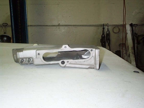

Here is what can be done to SLP runners.

Man thats nice 89GTA, but how far did you cut the mid sections out on the base side, I think I have read that it causes a lean condition on some cylinders or is that if you port the base that way. Thanks for the photo it helps, what measurment did you get on that, and also were you able to cut out those tangs without cutting through something? And how much higher do you think that helped the engine to pull? Sorry for so many questions but I need all the help I can get....LOL. I also want to mod the plenum and intake, do you have anymore photos you cand post for me, I would really be very greatfull , thanks for your time.

On the left side the mid section is completely gone and fully siamesed. On the right side of the picture I went in a far as I could and there is maybe 2 inches at most of runner left.
As to the lean condition that "may" happen if you port the base. I did not but had it Extrude Honed. I did have to have the edges built up on parts of the base side of the runners so that it would match the Edelbrock base better with the holes opened up. I'm close to 1.70 inch on the base runner side.
The engine pulls strongly to 6000 rpm which is my 1/2 shift point. It shifts around 5600-5700 on the 2/3 shift.
On the dyno peak HP is about 5000-5100 rpm and peak torque is around 4600rpm. Kinda makes an LS1 out of a TPI.
There is no practical runner left in the SLP's. The runner length is now reduced to the manifold at 6.125 inches and the heads at 6.00 inches. Total is 12.125 inch which is quite close to the LS1 runner length.
Also the plenum volume was increased a solid 50%.

Sanding drums turned out to be the best tools. I also became good friends with my local welder. I have been running the combo for a good 6 months. Interesting in that I still gained torque across the board with the mods. I work slow so it took me a few weeks to do it. I have to stop and think about the next step. Mistakes cost me to much.
As to tools I have a small lathe and a small bench mill. I made the bolt guides on my lathe. Hogged out a lot of the plenum and runners with the mill. Made the bosses on top of the runners and plenum with my mill. This could all be done with hand tools and a friendly welder.
With my next round of mods I hope to be well past the 400HP mark. If the stars aline and the moon is in the right spot maybe even 425HP at the crank. That would put me well into the low 12's. This would still be with TPI although modified.
