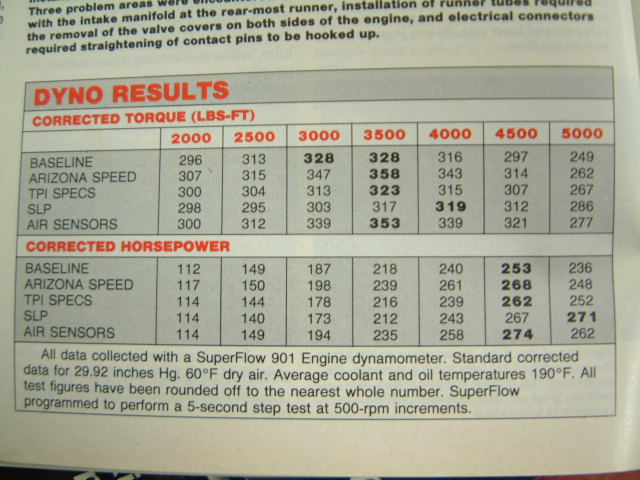

Nifty, sweet all around look - but no matter the runner diameter - that "Wave" has a long distance to travel to make it up to the plenum from the back of the valve. Cool intake, but why not just get the SuperRam if you're 90% there cost wise anyway?

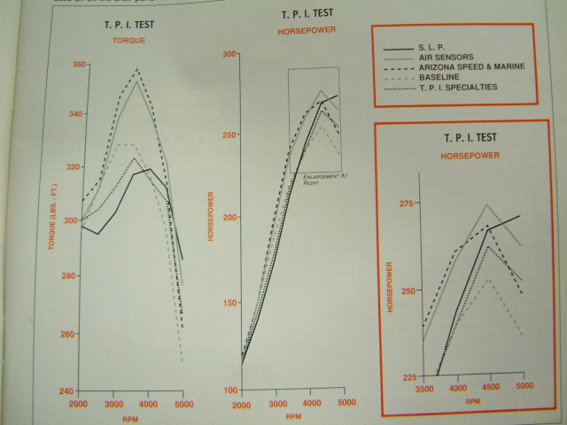

the FIRST set-up not only has larger runners, it has shorter runners, and a shorter cross section in the base. that's why everything is different from a TPI. -
Please take note of the torque graph - it mimics the stock TPI unit's graph, but with an additional 20 ft/lbs and 20 horsepower. If you feel there is more to discuss here, it's obvious you are in need of the information regaurding the first setup, not I.
