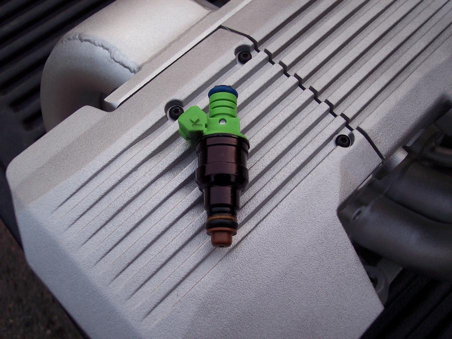

Well if the cap looks anthing like the one on this injector in this pic then it stays on.

Thank you everone who replied. The picture Tony89GTA put up is exactly what I have. Except for the colors. And yes my buddies injectors are 24lb ones as well. His are polished aluminum looking with no plastic tip and a three hole spray pattern.
