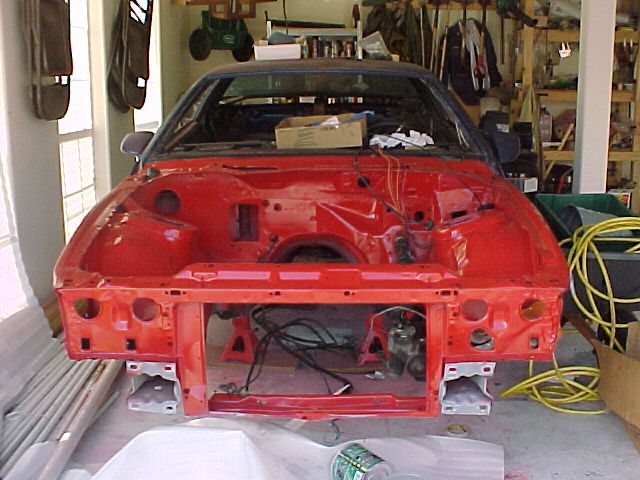

yeah lol...if it weighs 2100 lbs!!! Just take out the interior, dash, ac, radio, steering wheel column, transmission, rear end and motor...then you should have a 2100 lb car light enough to run a high 11!

Actually, a third gen camaro doesn't weigh all that much when every thing is off of it. I can pick my naked third gen up off the front jacks when the rear jacks are directly under the point where the lower control arm meets the frame. When I say naked I mean everything off except the steering column and box and the under dash stuff. I'll bet an F-Body frame is probably 500 pounds. I'll edit this in a minute and post a pic.
[This message has been edited by 92RSB4C (edited September 21, 2001).]
