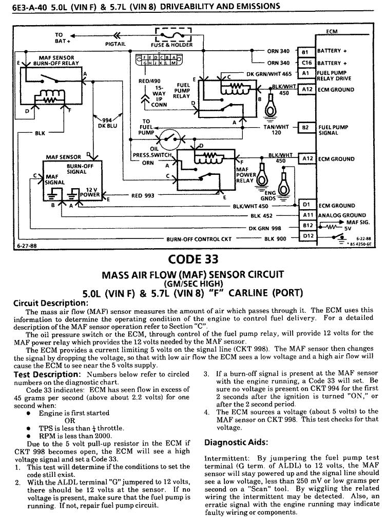

Maybe this pic from the GM manual will help find the issue.
Attached Thumbnails Code 33 (MAF) Mass Air Flow Sensor Problem-maf-code-33-relay

Yeah i just figured out how to read those charts. I have the tpi swapper guide and it has the same thing. I just need to find my test light to do the test. My last post about the mis, I unplugged the maf and intake temp sensor and it still does the same thing? Any ideas?
