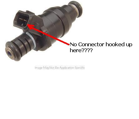

HI Maxont
Unless you are pulling our chain, no way can the engine run if you have the injectors disconnected. So we are on the same sheet of music, look at the picture - when you say the injectors are not hooked up, you mean no connector attached to the injector - Right?
thanks
Bill

the injectors are in the rail but there is no electrical hooked up to them
and no im not pulling anyones chain... im very confused myself.
ive already thought of the chance i could have hooked up the lines backwards and checked on it but it looks as if the 2 have different sizes and there is only 1 way to mate each up because the other they would not fit. i would double check that again though

haha for sure. so i have another question for everyone still keeping up on this post. i baught some new spark plug wires from a local warehouse and they were supose to be hei plug wires but they came in non hei wires. to my knowledge the only difference was the boots on them. so instead of ordering a whole new set i just had the guy that ordered them for me throw in the correct boots and off i went. so as of now im running non hei wires... could it be some possible way that non hei wires cant actually carry the correct voltage to the plug or something of that nature?

I am new to the forum and am trying to solve the same problem with my father-in-law's 1988 Z-28 (305 CI) TPI. With the injectors electrically plugged in, it floods the intake manifold & cylinders. Unplugging them, however, allows it to run so long as residual fuel remains.
His has the cold start valve (basically a 9th injector) which actually allows the engine to run, at idle speed, even though all other injectors are unplugged.
While it is running at idle speed he sequentially plugged in the other injectors. As more of the injectors were plugged in, it began to run rougher and rougher until it finally died.
My suspicions are 1. faulty powertrain control module; 2. faulty mass airflow sensor; or 3. other faulty sensor (e.g. MAP) or vacuum leak. This forum has helped and I will be checking for other sources, such as the suggested leaking fuel pressure regulator diaphragm.
I have verified correct ohms at injectors and correct voltage of TPS at idle position. I will be checking MAP and MAF voltages as well as fuel pressure tomorrow.
No. Universal sets (one's you put together yourself) come with both sets f connectors and boots.
Do a search into injector driver. I believe it's part of the ECM. It may be the cause of your problems.
