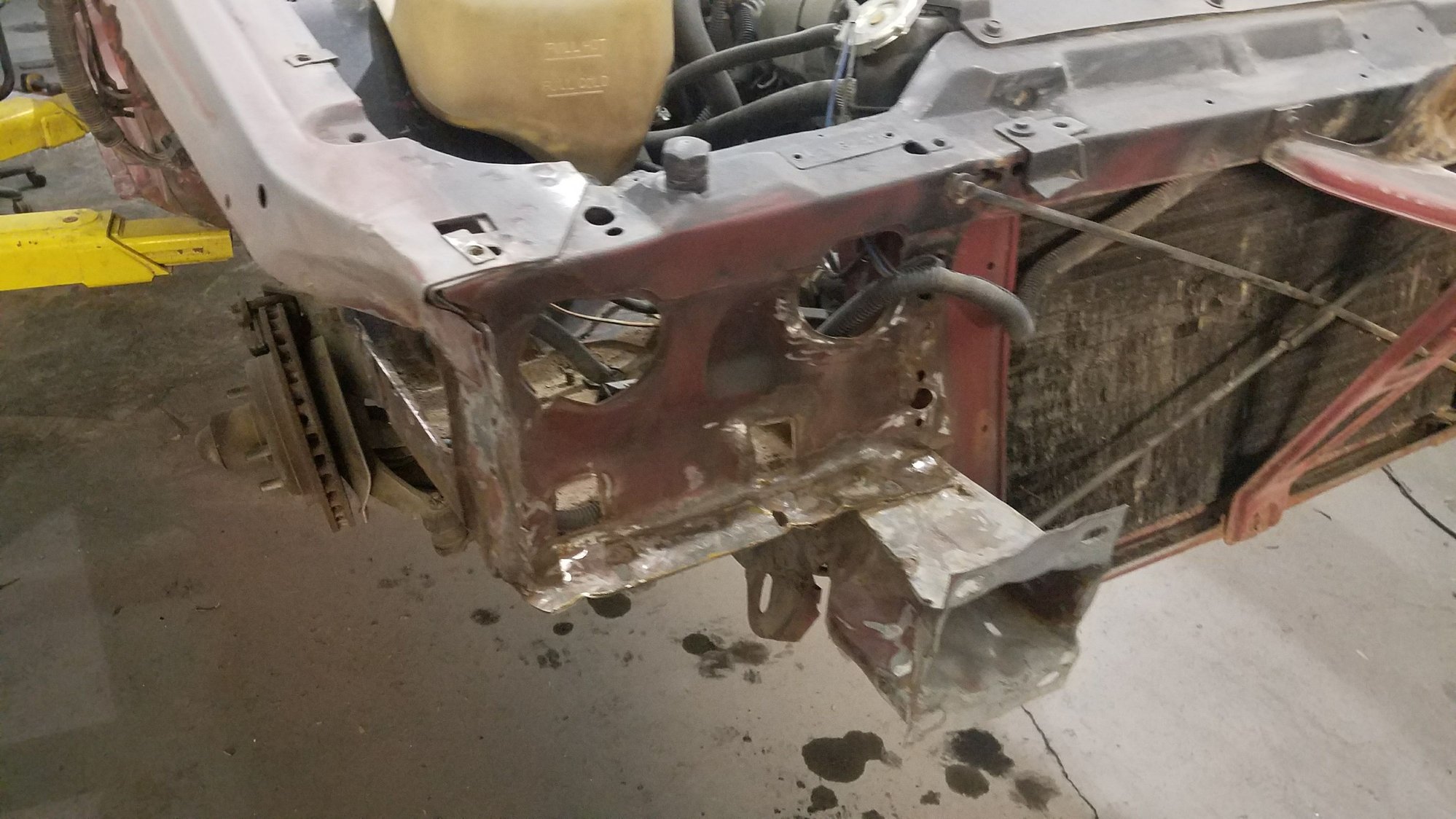

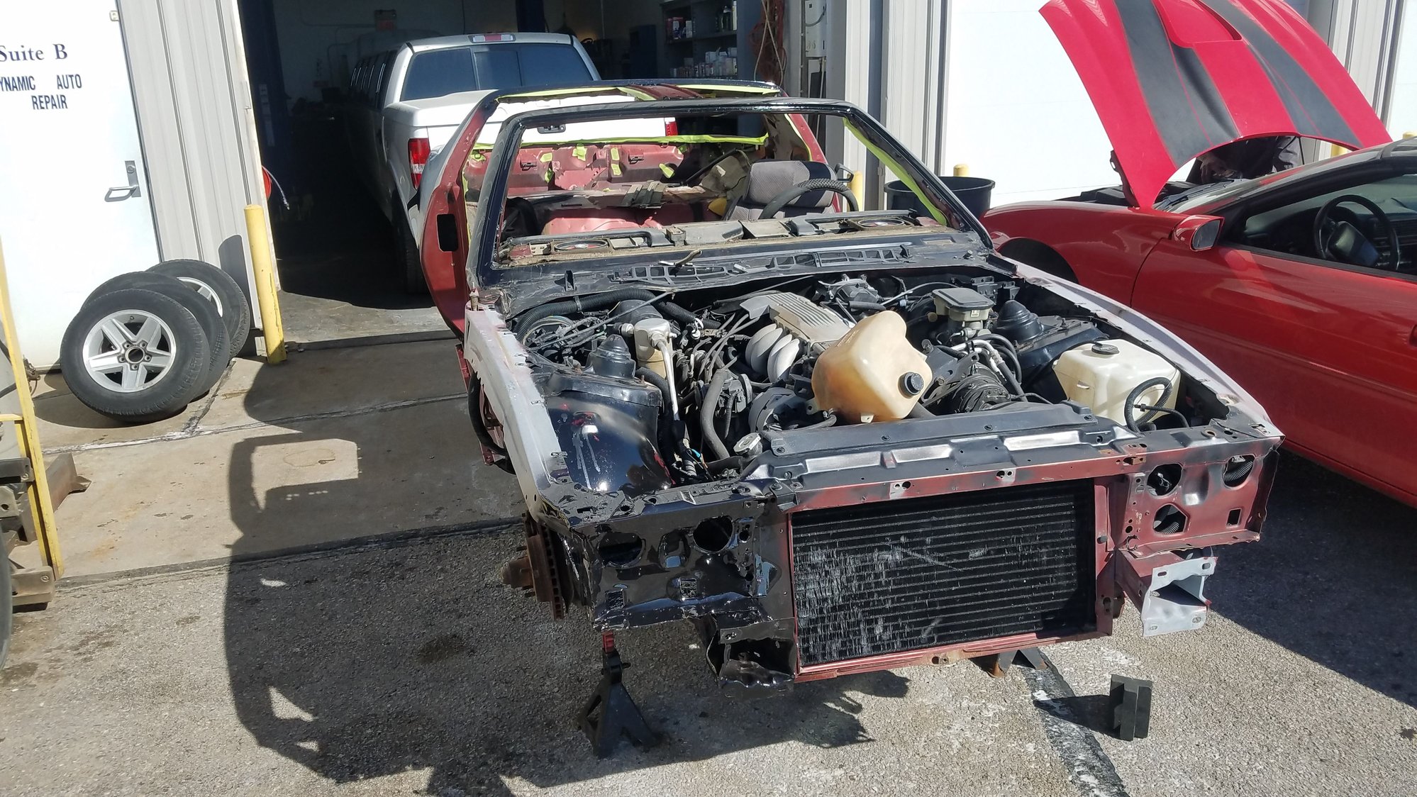

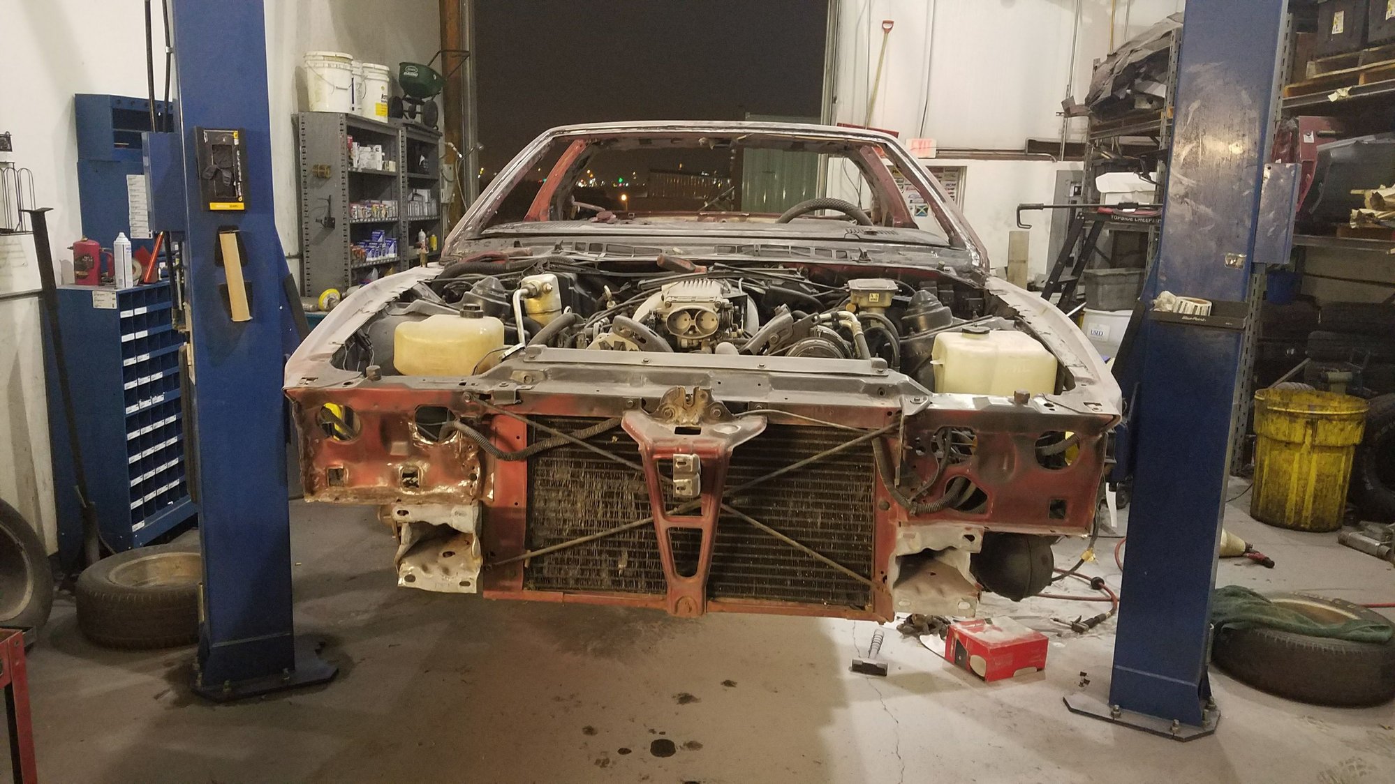

Old Sep 21, 2017 | 01:09 PM
deus402's Avatar
Joined: Jan 2006
Posts: 37
Transmission: 4l60e (700r4)
Axle/Gears: 4.10
Re: Adding horsepower while keeping stock parts...
slight fender bender in the right front corner, needed paint anyways.

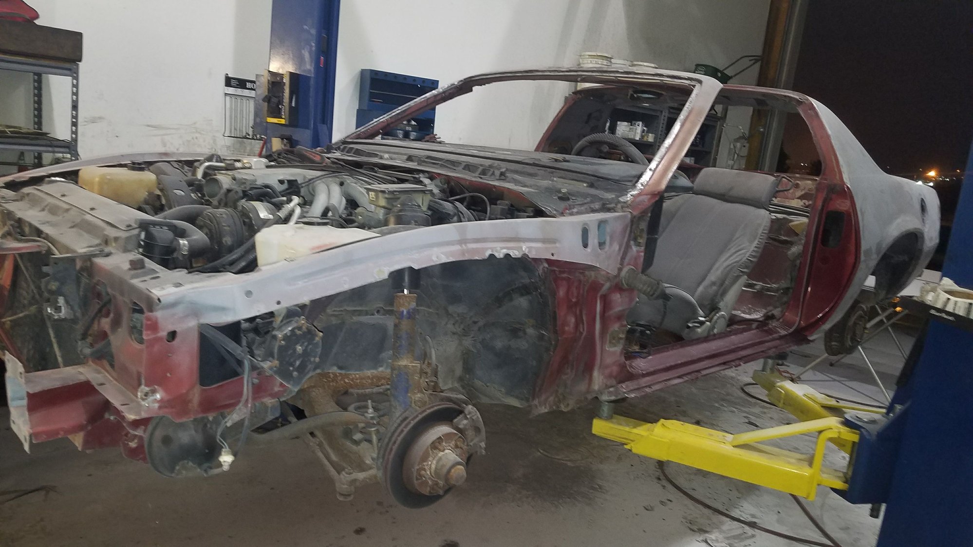

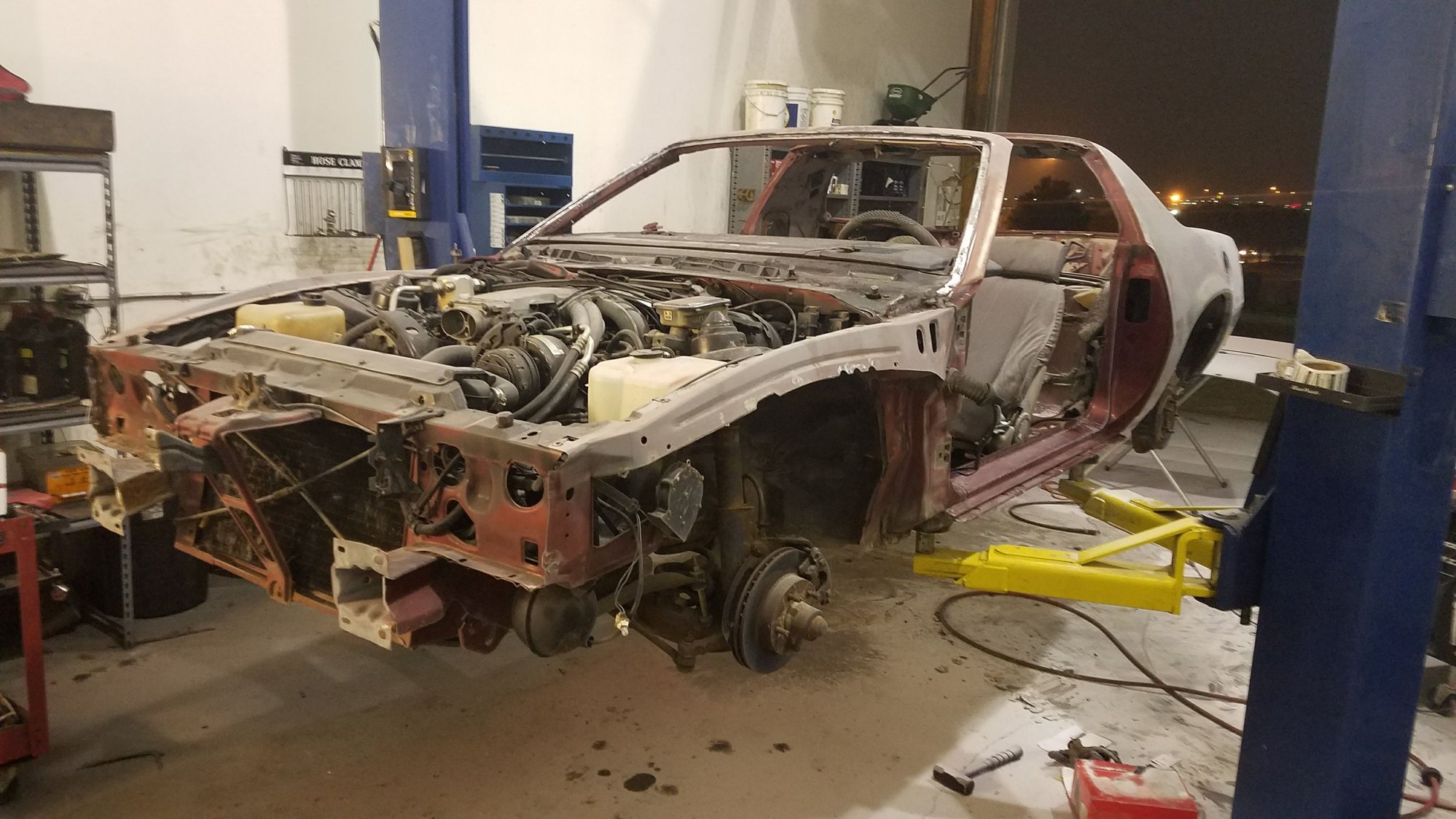

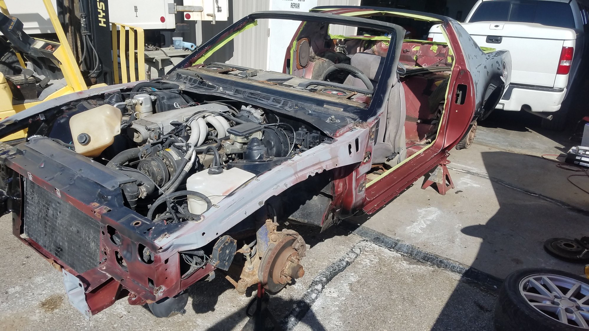

Old Sep 21, 2017 | 01:13 PM
deus402's Avatar
Joined: Jan 2006
Posts: 37
Axle/Gears: 4.10
Mostly done with soda blasting and stripping rust and bad paint.

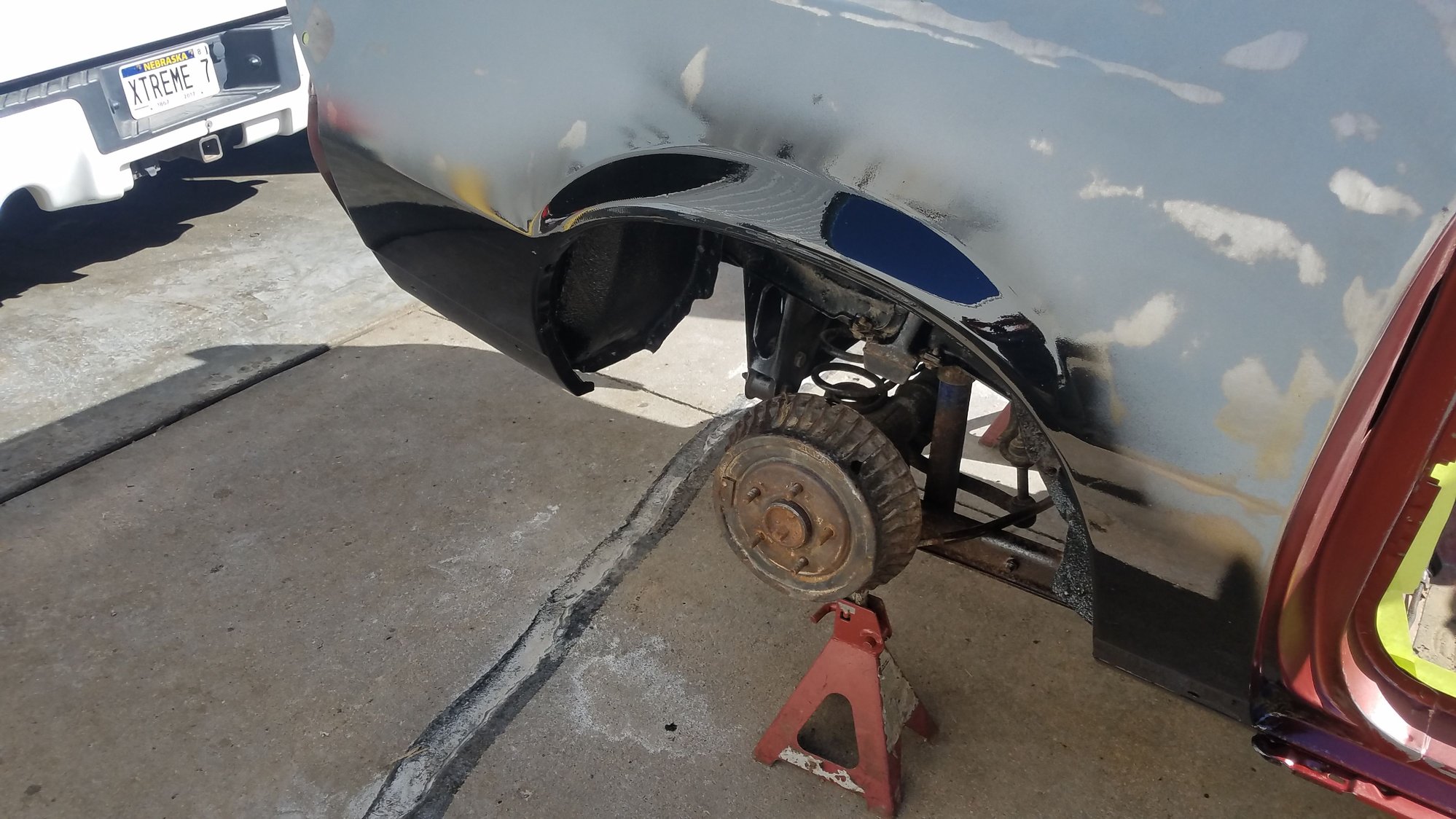

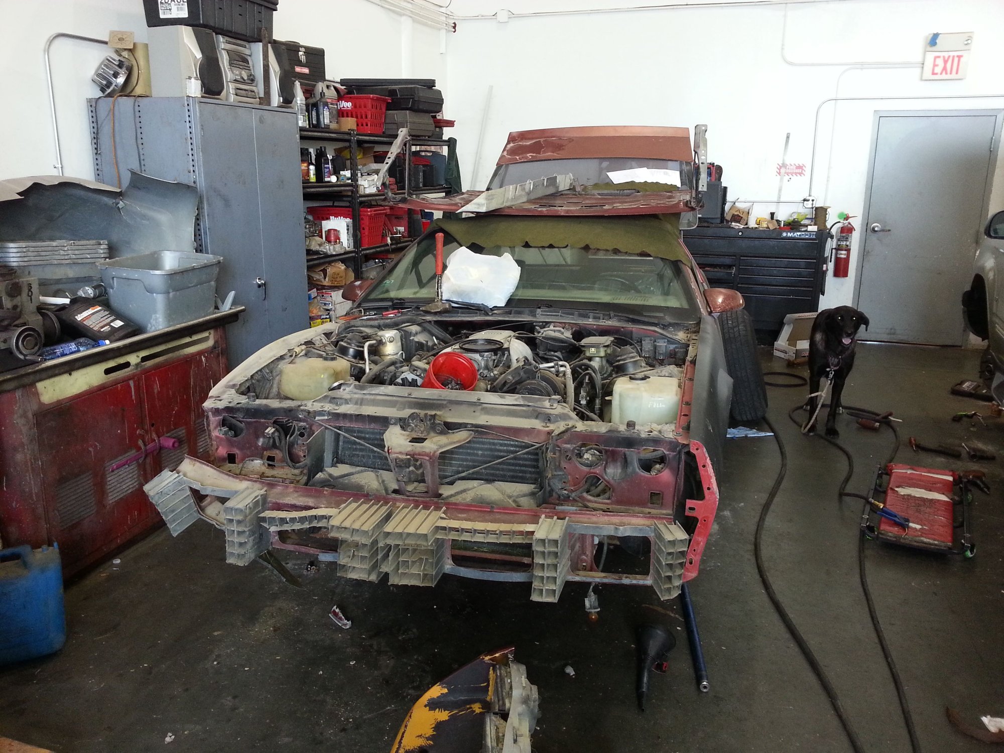

Old Sep 21, 2017 | 01:16 PM
deus402's Avatar
Joined: Jan 2006
Posts: 37
Axle/Gears: 4.10
Got all the problem areas coated in POR15 yesterday, today i'm working on getting the POR15 scuffed up to spray primer.

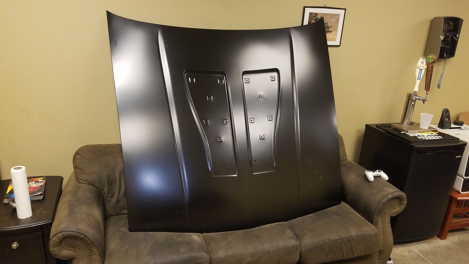

deus402's Avatar
Joined: Jan 2006
Posts: 37
Axle/Gears: 4.10
New hood showed up today as well.
