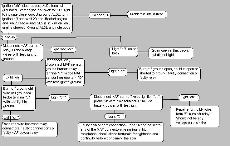

Here's a quick rundown of the code 36.
This test will determine if the burnoff operation is active or if the code was
set by an intermittent condition. First, check for 12volt supply to the burnoff
relay and grounding CKT 900 should energize the relay.
To do that, make a jumper wire at ECM connector E12 and test light it.
If that is dim, then you have a possible corroded or bad connections. If
it passes the test, replace relay. Forgive the "techno babble" I meant
to post the electrical diagram, but I cannot find it.. Ill get one up!
Someone mocked up a troubleshooting chart to help in the meantime, rather helpful ^ ^
Good hunting!
