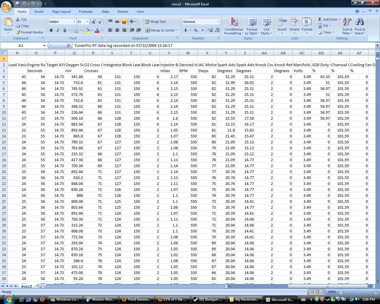

Re: Failed E-test AGAIN... So we plugged it in..
Here they are... Notice the oxygen sensor.... What about my MAF?

Old Jul 24, 2009 | 04:11 PM

And the other half.. Almost forgot.
Attached Thumbnails Failed E-test AGAIN... So we plugged it in..-irocz12.jpg   Failed E-test AGAIN... So we plugged it in..-irocz22.jpg
Block learns at 145 - 150 is not good. They should be close if not 128.
The O2 reading determines the BLM's, so a bad O2 sensor could cause the problem.
The O2 sensor could be reading fine and the readings could be the result of several mechanical problems.
There are many possible causes, but I'll give you a brief list of stuff to check for.
*Vacuum leak between MAF and manifold base.
*misfires caused by ignition malfunction - check plugs
*faulty fuel injector or injectors - clogged or failing
*exhaust leak upstream of the O2 sensor
*ECM calibration is not a good match for engine combination
*faulty fuel pump or fuel pressure regulator
*Vacuum leak between MAF and manifold base. -
We went around with a can of quickstart and it didn't change idle
*misfires caused by ignition malfunction - check plugs - Brand new AC Delco
*faulty fuel injector or injectors - clogged or failing - Tested at 16 ohms for all of them
*exhaust leak upstream of the O2 sensor - Most likely the problem, you can hear a major leak toward the front.
*ECM calibration is not a good match for engine combination - What do you mean hear?
*faulty fuel pump or fuel pressure regulator - Changed in 2005 by a previous owner
My money would be on the O2 reading a false lean condition given the leak you mentioned. If your O2 is bad (or is getting extra O2 in the exhaust stream from a leak...) and is therefore indicating a lean condition when it's not actually lean, and the car is adding fuel to compensate (i.e. high BLM's), then that could cause a rich scenario which would result in increased HC's...
Forcing open loop *might* help (by taking the false reading O2 out of the picture and running uncompensated default fuel amounts, defaults might be a little rich though I can't remember)... But, it would only be a temporary hack kind of fix, if it even works...
