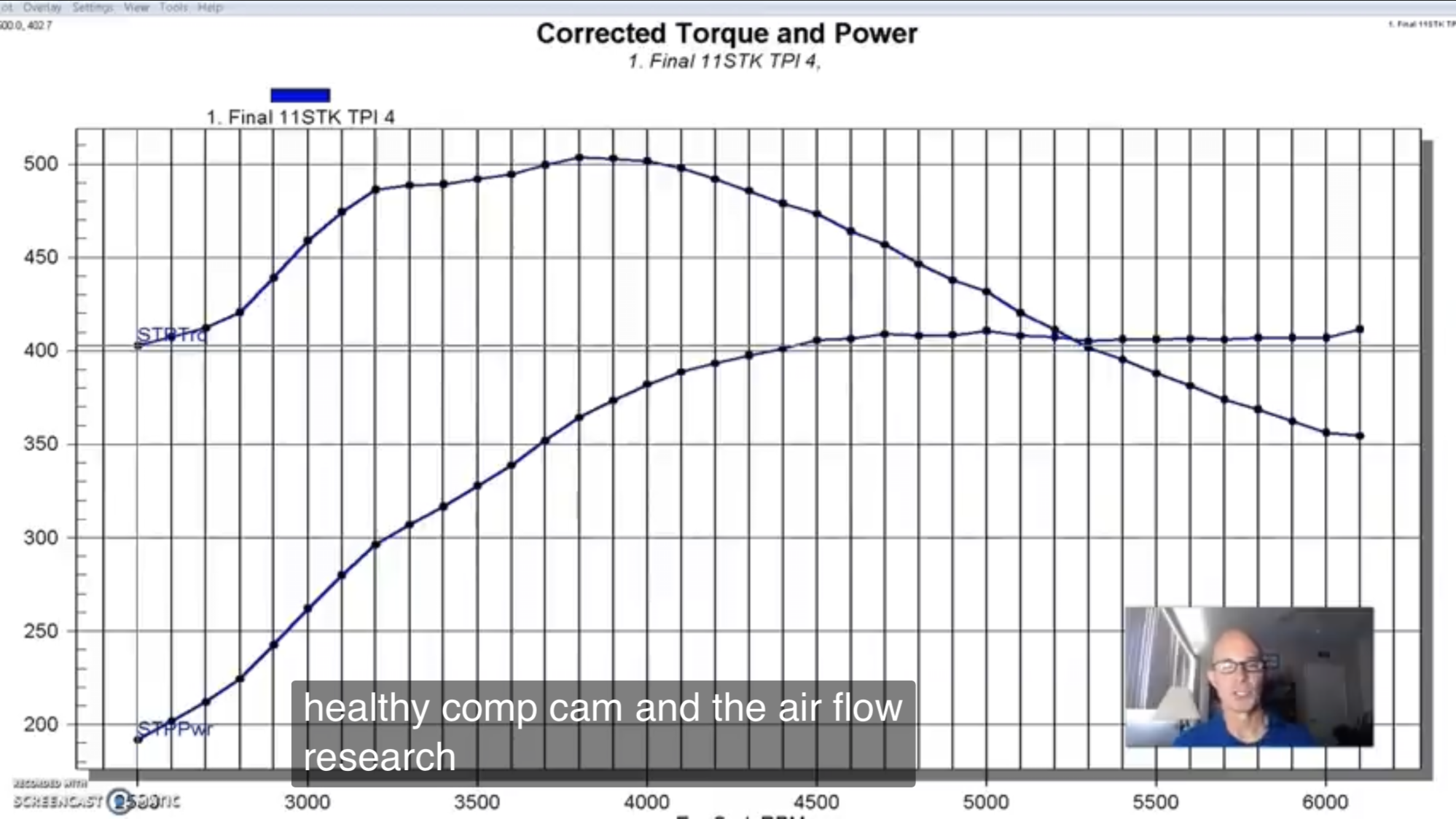

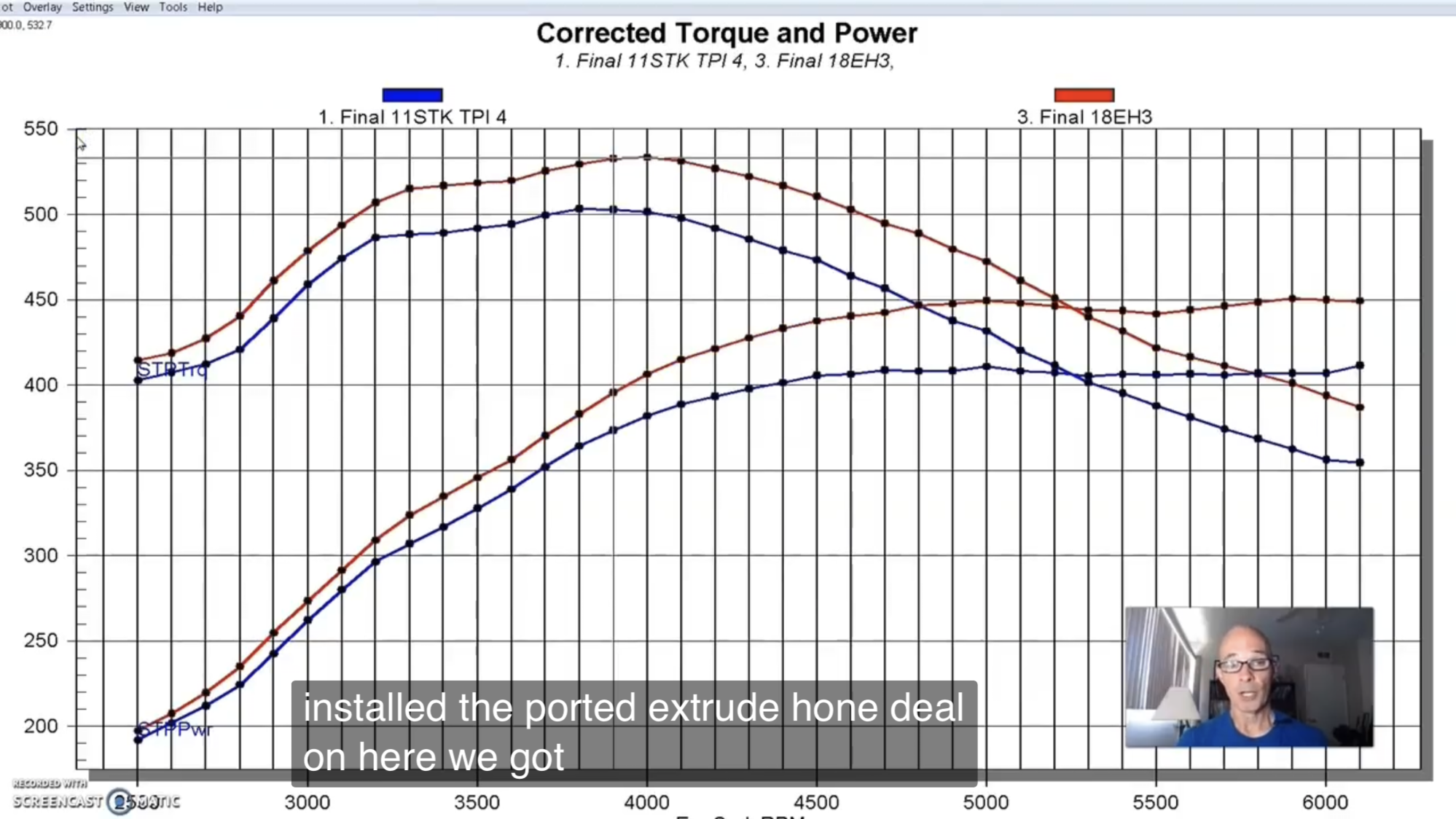

So this is from Holdener on a 383 with a healthy cam. The CAM prevents the intake from really dropping off on power
Test 1 is stock TPI
Test 2 is ported lower TPIS big tube runners and a ported plenum.
Test 2

That's interesting, but not really informative. What is the left (vertical) axis graduation? Kilowatts, Joule-Seconds, Newton-meters, Kcal/Cal, power factor of the dynamometer, or something else?
Also, what 383? Is it a "modern" overbored 350 stroked out, or a de-stroked Mk IV big block? Nearly everyone here remembers our member "Smitty" who was putting insane power numbers out of a "305" and many didn't believe the claims. Then everyone found out that the "305" was indeed 305 CID, but was the product of a de-stroked 4" bore engine.
Details.
Details.
that's just the tpi test that's been posted here for decades now. Holdener made a video highlighting the test and has also been posted numerous times.

1) Left axis is “power level” in torque and HP represented by the 4 lines in each graph
2) I don’t know of any de-stroked big blocks that are able to run a TPI system from a SBC
I also don’t know of any other Chevy 383 combos that aren’t 4.030 bore X 3.75 stroke
Old Sep 13, 2021 | 09:23 AM
Mercruiser 6.3L, GM HT383 or ZZ383 is 4.00x3.80.
From memory a 0.030" over 400 (4.155" bore) with a 3.48" crank is also a 383.
Holdener tried TPI on a L99 265 baby LT1. It lost top-end power compared to the short runner LT1 intake.

Yeah there are exceptions to the 4.030x3.75 of course.
Out of 100 383’s 99 of them will be the 4.030x3.75 build
ALL engines will lose top end with a TPI and that 4.3 test demonstrates the TPI/327 combination won’t do what some in this thread think it will
