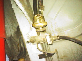

I have a '90 Iroc-Z with a 5.0L TPI and I'm having Isues. I changed the Cap & Rotor, Ignition Module, Coil, and Spark Plugs thinking that would solve the problem. That didnt help so then I changed the Knock Sensor and MAP sensor. After that I found out that the Timing was off. Every time I set the initial timing to 6 degrees like the specs ask for the car runs beautiful with full power for about a mile or so then it gives and runs like crap all over again. The computer advances the timing for some odd reason. The computer isn't throwing out any codes NO matter how much of a rough idle it has. Now the car wont turn over at all and after cranking it over so many times trying to figure out what's wrong, I fried my starter solenoid and I waiting for my replacement. I'm looking for any other sugestions as well.
Also, Do any1 have any idea of what this Beige thing is in this picture ...? It's located behind the fuel tank
Attachment 199497
Attachment 199499
Attachment 199498
Just a Curious question.

Sounds like the same problem we were experiencing. New injectors were the ticket for me. I don't know anything about the TrickFlow injectors but everyone I spoke with on here as well others who know injectors all recommended bosch. Have you found a better price on the TrickFlows? Most of the places that offer rebuilt Bosch's have great prices compared to even new OEM injectors.
?? as for the beige thing. Looks like some sort of breather but don't know why it would be on there in a pressurized fuel system. ??

I was just curious about the Trick Flows.... They're $259 so I was just curious if its worth the extra $60...
I dont have any idea of the beige thing either but its there with a bracket to support it so I'm pretty sure it came stock with it
