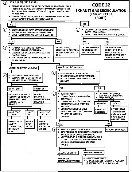

troubleshooting trees and diagrams. might help untill some of the senior members come in
Attached Thumbnails Code 32 help anybody?!?!-87-trans-code-32   Code 32 help anybody?!?!-87-trans-code-32

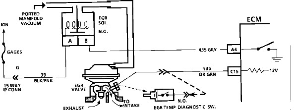

My situation is that the solenoid is not grounding out to open EGR. Solenoid works as tested, EGR is new..Is this a ECM issue, perhaps A4 circuit that grounds the solenoid..OR is it false temperature reading from the CTS on the manifold.?. Seeing if I need to pay out 13$ or not-haha
