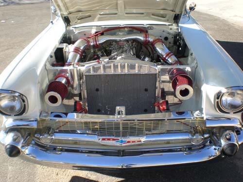

Dual Intake/Plenum?
anyone ever done it?

Re: Dual Intake/Plenum?
Done what, exactly? That's a carb in the picture.
sorry..shoulda been more specific...has anyone done a dual intake setup like that on a TPI?
do you mean dual cai? SLP use to make one but there rare and expensive now. At first i thought you ment two tpi intakes with 4 runners on each intake all on one engine, now that would be awesome
lol..yeah that would but yeah i mean a dual CAI setup..ive seen the k&n one but i wanna see custom made ones i guess....
