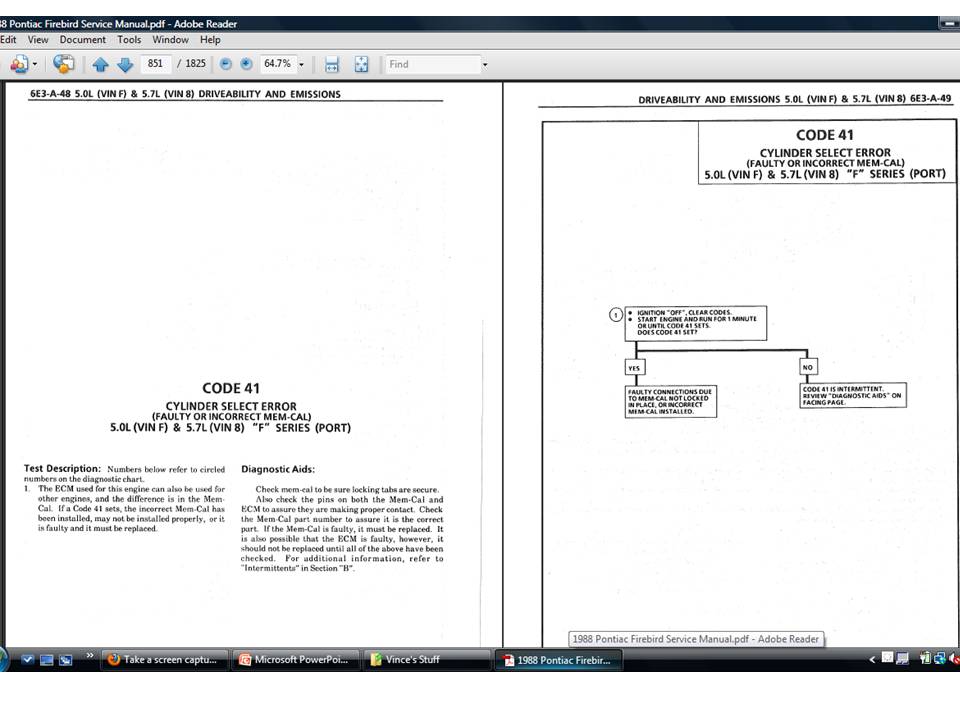

I read up on code 41 and attached what I could. You mentioned something about an autotech chip...seems that your memcal may be wrong or not seated properly.
Hope this helps.

Old Dec 13, 2011 | 12:23 PM
Pajjen's Avatar
Joined: Feb 2011
Posts: 57
From: Finland
Car: Pontiac Trans Am GTA -87
Engine: 5.7 TPI
Re: 350 TPI problem
Thank you.
I will check that.
