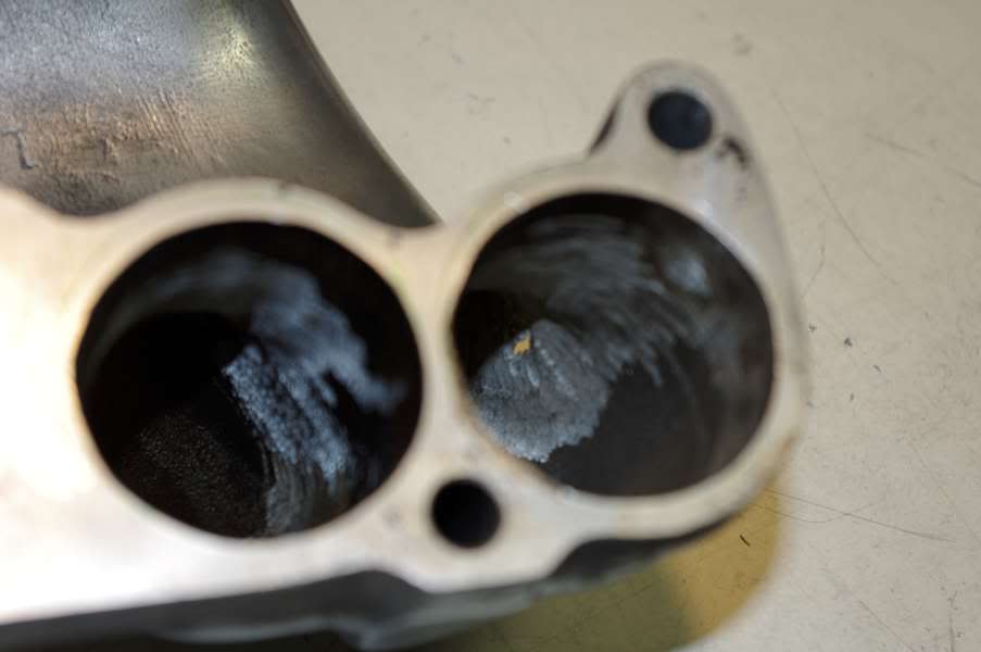

Some SLPs. Someones "plenum.com" got ahold of these and cracked them ina vise so I got them welded up and blended it all in prior to porting (which I WISH I had pics of)
Unless you port these all the way through youre throwing your money down the toilet
Getting the flash off is not going to do anything. Dig into them, get yourself some volume

that scuffing is what someone called "ported". poor guy

Re: SLP Runner porting techniques?
Originally Posted by TTOP350
Thats what I did but I just ground them until they were smooth then welded them up. Its a very small hole to weld
Funny you mentioned that. Guess what I did tonight? I'm not a welder, so I used JB Weld to fix the mistakes. Since the runners are dry, I don't anticipate any problems, but if I do have a problem, I'll re-do them with a better epoxy.
Incase anybody was wondering, you can go slightly less than this far without going through. You can't really tell in the pics, but those bumps are pretty much completely gone. Out of 10 bumps, I only went through on 2, so I guess that's not too bad. Hopefully I don't go through any more when I clean them up with the sand paper rolls.
JB Weld to the rescue:
