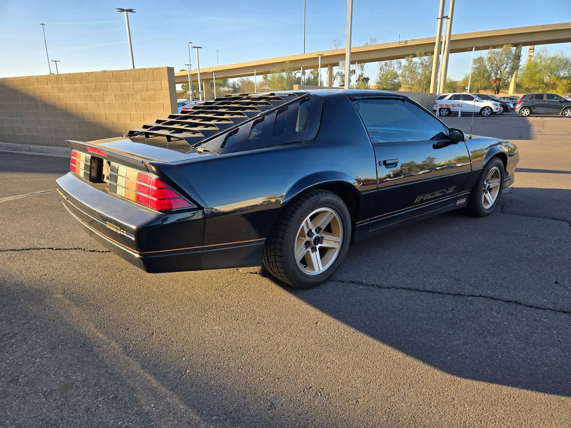

just got a third gen and excited to start working on it.
want to increase HP, i know it wont be much because its a 305 but would like to keep engine as is (somewhat) and just get some performance part.
any ideas?
any ideas?
