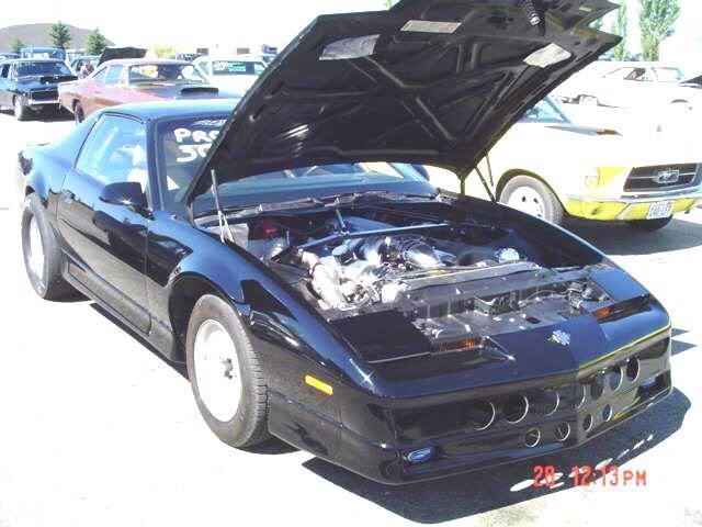

I can't find the article but I saved the picture of the car. Nobody said anything about naturally aspired motors.
I think it may be twin turbo. And puts over 700hp to the wheels.
And response to what others have said, theyre right. Don't expect huge gains. I thought of it as an investment for the future. You wil get much more out of the motor when you go for a heads, cam combo. Just like everything with a motor their is more then one way to reach your goals. Some cheaper then other but I guess it's all about preference. I like the tpi so I stuck with it. To each his own.
