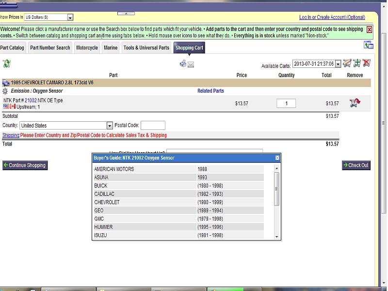

Just a heads up for anyone interested: Rockauto has the NTK O2 Sensor (Part # 21002) for $13.57 (not including shipping). Pretty much cannot beat that price!
Good luck all!
