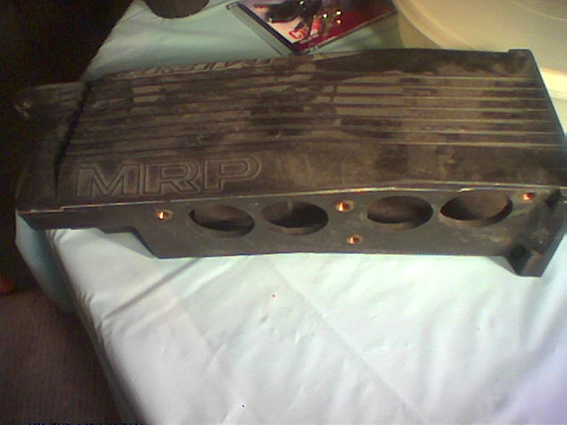

I wish Mrp still made the plenums That would be neat to have.

[quote=Tuned Performance;5555271]I wish Mrp still made the plenums That would be neat to have.
Brian, I,ve never heard of MRP. That plenum looks to be some sort of composite with threaded inserts. I would assume pretty rare.

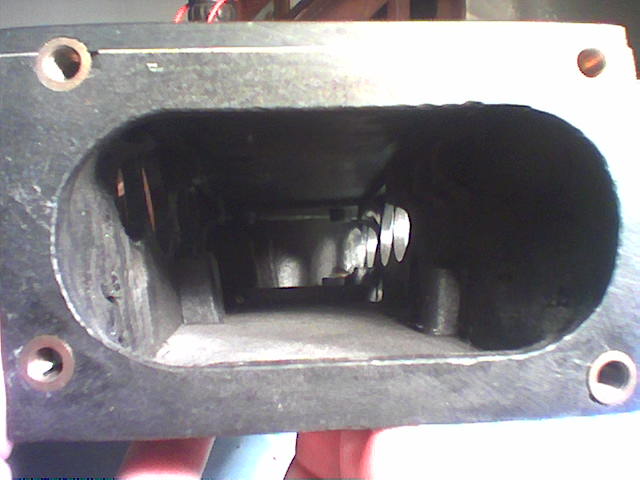

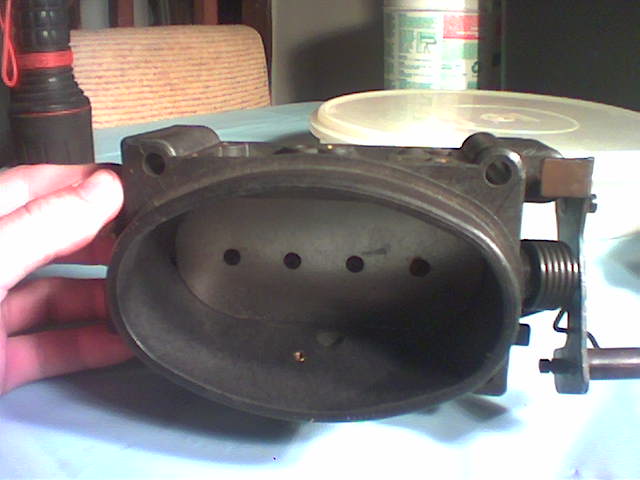

Re: TPI Plenum Heat Reflecting Coating
it is very rare I have only seen 1 and don't think very many were produced. Would be neat to see the Dyno results and heat loss. I have heard they made runners as wel but have never seen. Picture of them.

Those things were a piece of junk, that must have been what.. 20 years ago? They made the palstic plenum and the tB. Reports of the thing coming apart, the thhrottle blade stickign in the housing etc. etc. MRP went belly up pretty quickly. Probably because of all the issues

the idea of a composite plenum is a good idea, but the throttle body looks like it belongs on a model engine. Yeh I think it was more than 20 years ago my love of gm mpfi goes way back the mechanical Rochester unit looked cool too. Some guys have all the McFarland toys lol
