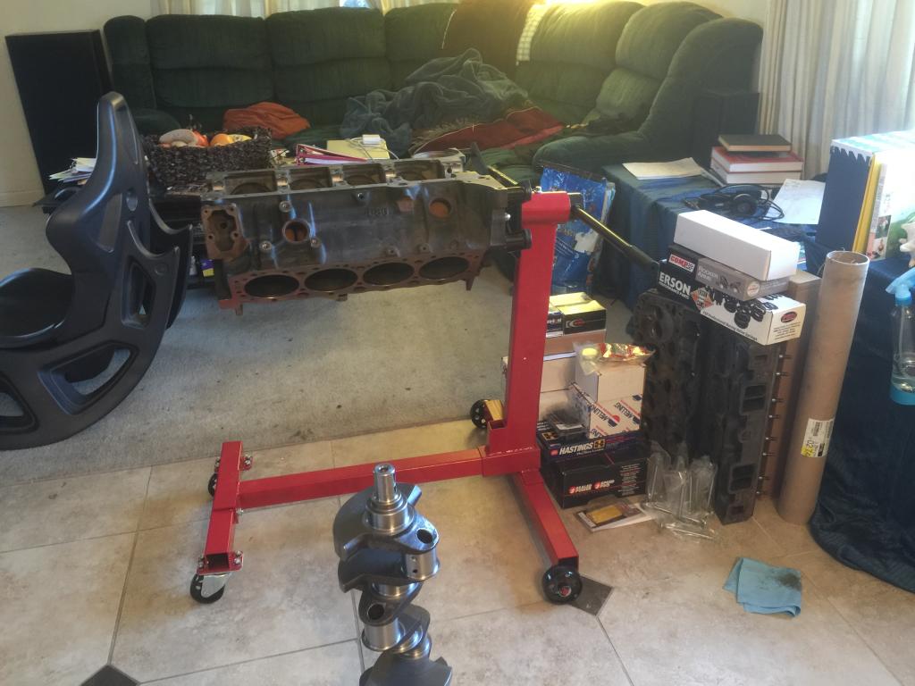

I've purchased the kit for the 383 and it is currently being balanced at the shop. Got the 4 bolt main vortec block cleaned and decked. The next step is to clearance the block to accommodate the 383, and of course send it off for bore and line hone. I've finally got some pictures for any lurkers in the thread.
Here are the heads and all the gear. I'm debating whether or not I'm going to deck them down to increase the CR.

Me tearing to motor down, followed by a shot of the vortec block in the van at the junkyard:

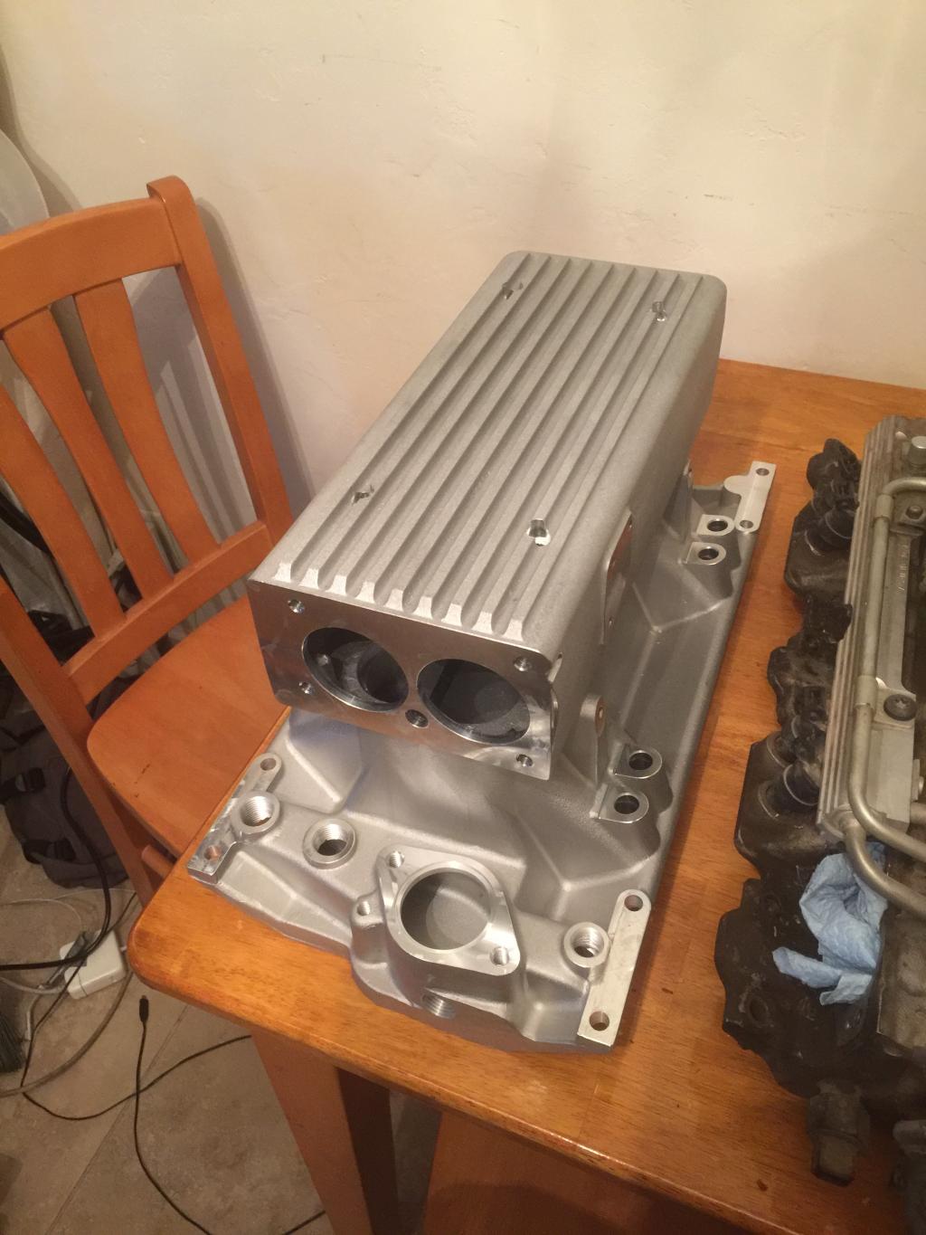

HSR:

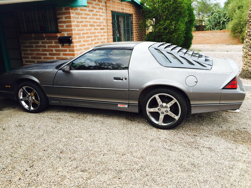

Engine is in the car and "running" albeit poorly. I fought with fuel issues for a while, and am still struggling to find the ideal timing. Since I don't have the tools or space to do exhaust welding myself, I plan on taking it to an exhaust shop to pipe the Hedman LTs back to the borla cat back I installed recently.
Feast your eyes:
On my first trip over, the headers cooked the wiring going to the fuel pump, so it's back in the driveway. Looks like I'm going to need to fab some side pipes just to get the thing to the exhaust shop. Times like these make me wonder why I don't have a truck with a trailer...
The engine is a bit of a dog. Throttle response is REALLY laggy, it idles like a boiling kettle of tar, and I am unsure if the electronic fan is going to come on once it runs long enough to get up to operating temperature.
I have not burned a chip for this thing yet - if anyone has experience with chip burning with HSRs along with my series of other mods, I'd like to ask what it changes and why it is necessary.
