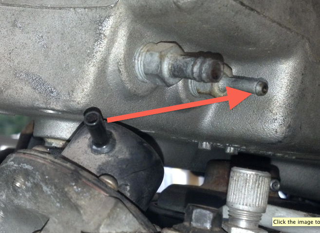

All vaccuum lines have a purpose/function. Determine if you are deleting that function, which then tells you which vaccuum lines you can eliminate.
Pic #1 - connection the AFPR to the smaller vac port.
Pic #2 - that goes to the power brake booster.

The other manifold vacuum fitting next to the fpr goes to your havac controls & cruise control if applicable .
