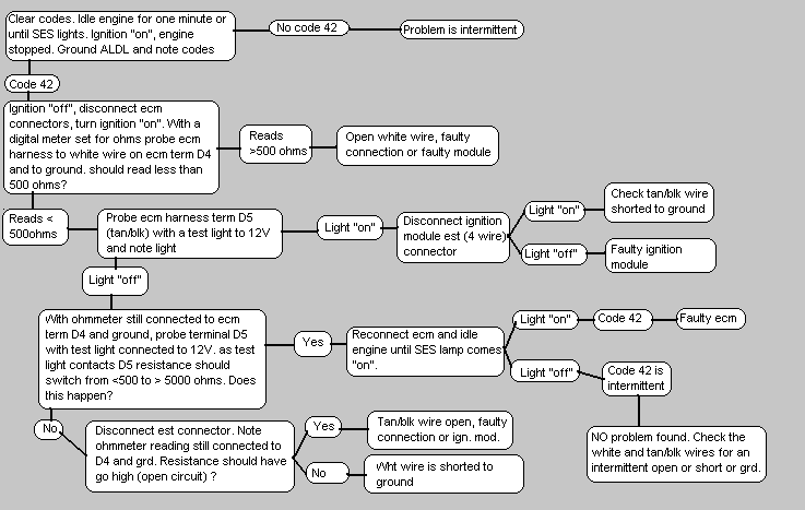

Good you have fuel pressure and new injectors, pump runs. Concentrate on the code 42 problem. Follow this troubleshooting chart to help in your diagnosis. HTH!

Helpful chart cept, car wont start. Says to let engine idle and see if the code comes back. If the car wont start i dont think i can follow this...

IMO, the first step in the diagram is to verify that code 42 is still valid. In other words, that the problem still exists. It won't hurt to ohm out the suggested items to see if anything is off.

Just start where you have verified code 42, no need for you to do step 1 as you have verified code 42 already.
The ECM will not pulse the injectors if it doesn't receive pulses from the distributor. To verify this, do as Dyno Don suggests and spray starting fluid into the throttle body to see if it will fire. Follow the steps in the chart to find the cause of your problem. GL!

That walk threw doesn't work for me. I believe thats geared toward the 86-89 Camaros. The wires and pinouts on my ECM are differant (there is no white wire at D4 - there is no wire period).

Follow the troubleshooting chart by wire color and then reference to the pin number, in the diagram, for the 730 ECM.
