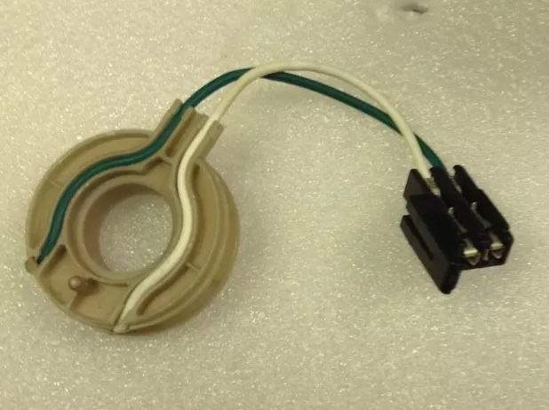

I just swapped out the Ignition Module with a new Standard one... Didn't help. Pulse coil and Reluctor? I noticed that the Pulse coil will move(rotate) about 15 degrees when I changed the ICM. Is it supposed to do that?

Is it the reluctor (moving pole piece) that moves or the pickup coil/pole piece? The reluctor should not move relative to the distributor shaft. The distributor
The piece that connects to the two wires that go to the ICM. It will rotate about 15 degrees around the distributor shaft.

Re: Hiccup at lite throttle cruising Pulse Coil?
That sounds like you are describing the pickup coil. It should be retained by screws to the mounting plate/fixed pole piece, and the plate should be pinned to the distributor body to prevent this rotation.
It should look a little like this:
I'm going pull it out prob next weekend. The piece that moves is this one...
That is the pickup coil itself. It should be secured by a locating pin, but movement there is not as big a concern as movement of the pole pieces. The coil itself is not actually timed to anything. Instead, its proximity to the magnetic (fixed) pole piece and reluctor causes an electrical impulse to be generated in the coil whenever the pole pieces align. While moving is not a great thing, but may not be the sole problem.
