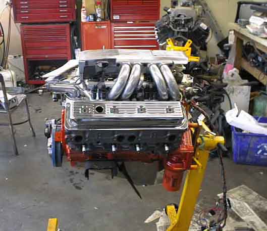

Hey everyone.... I was asking about the EGR wall removal in the plenum a little while back. I finally got to it tonight, and it is much simpler than I though. Thanx for the pics everyone. Will I see about a tenth gain in the 1/4?
Car should be back together soon... got th einjectors back last week, have the plenum ported and externally polished, just have to clean up the intake and finish polishing th eback of the runners. Can't wait to hear my baby run again... I may just take it out for a spin too Just to see If I can feel a difference.
Oh... A note fro anyone changing the FPR to a AFPR... you need that damn special torx screwdriver with the middle drilled out to go over the freaking tit in the middle.. grrrrrr... that set me back a little bit tonight.

Attached Thumbnails Update on porting the plenum-tpi-406-cropped-engine
