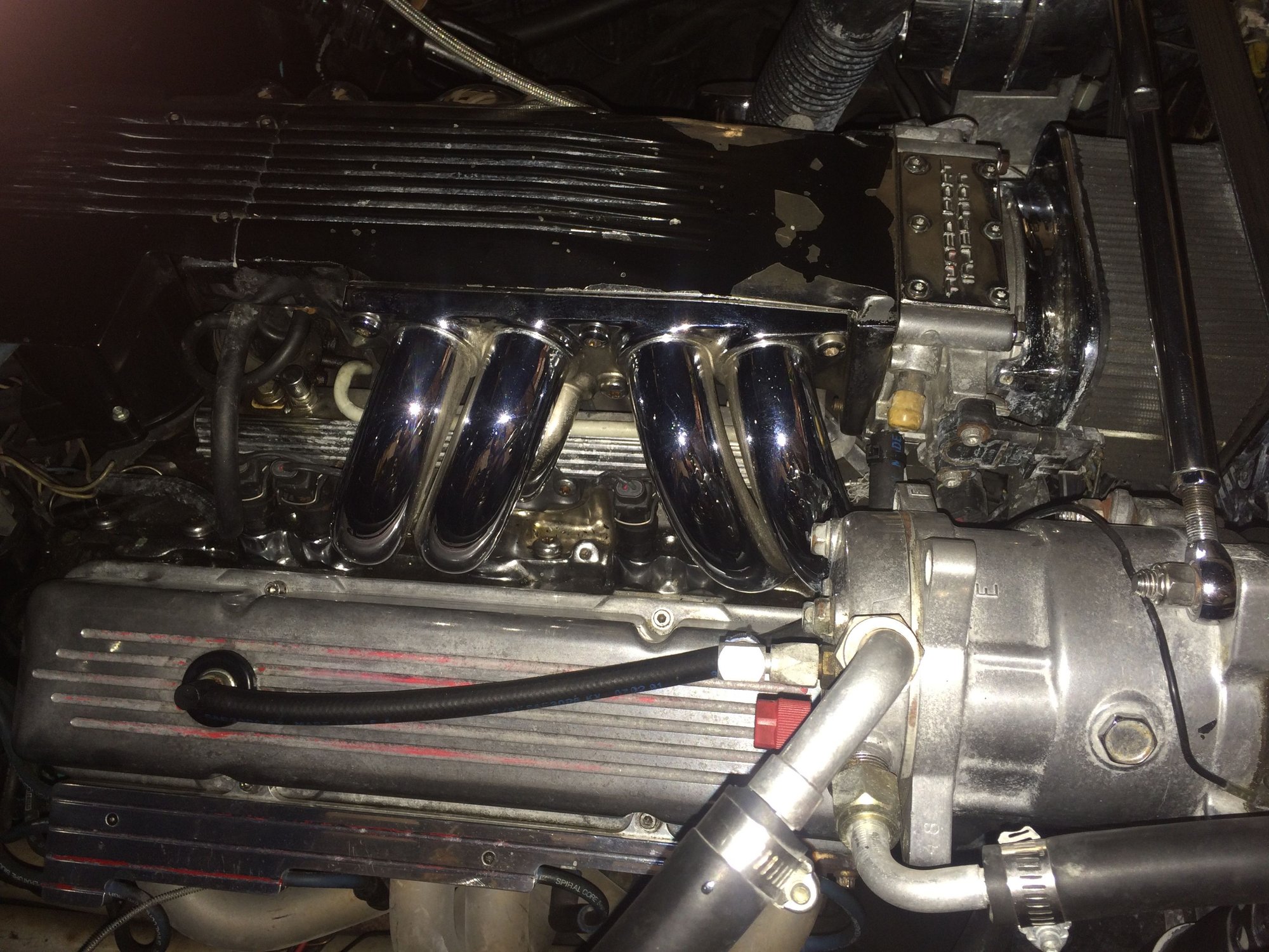

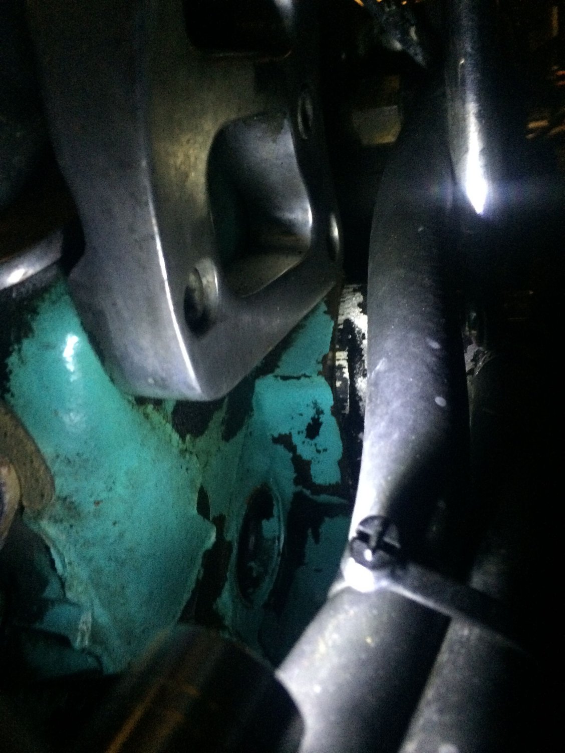

I'm looking for the pad in front of the head but it must be covered by the alternator bracket. It is definitely TPI injected. I found the "CED" on the passenger side of the block behind the header and under the head.
Front passenger head and water pump
Old Sep 1, 2016 | 09:22 AM
rarebmx's Avatar
iTrader: (6)
Joined: Oct 2011
Posts: 914
Likes: 16
From: Imperial, Missouri
Car: 89 IROC/89 Vert/87 Vert/89 GTA Vert
Engine: 5.7/5.0/5.0/5.7
Axle/Gears: 9" 2.77/9" 3:23/9" 3:42
Re: Numbers on engine block
Under A/C compressor

The Blue color is somewhat of a dead giveaway too -- IIRC, there were no factory Blue SBCs after 1982, and Blue is not a very popular color choice for a block repaint.
Old Sep 7, 2016 | 07:09 PM
Gangsta Stude's Avatar
Joined: Aug 2016
Posts: 15
From: Tidewater VA
Car: 1940 Studebaker Commander
Engine: TPI 350
Yea, not a big fan of the color. It's like a Seafoam Green/Teal Green/Carolina Blue mixture. Personally would prefer black.
