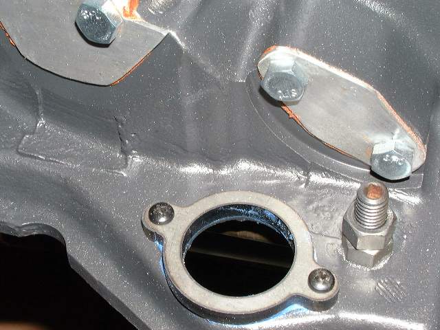

Im not John but I think I can probably help. If you look at this pic(sorry, not sure if this is Johns or RCRs) you can see how close the egr is to the distributor. That pretty much means no egr right there, but maybe you could fabricate some kind of external egr?

The above picture would be RCR's. He's got the pretty dist spacer.
Anyway, it is so close to the dist that I WOULD say it's impossible but I never say that word anymore. People told me that a LT1 intake would not fit at all. Well....
FAST has a a product that eliminates the distributor, called the eDist. Uses coil packs. Then you could run EGR.

I was wondering, and i probably would be sinking myself into more trouble than i can ask for, but i believe the V6's run an external egr. Wouldn't it be possible provideing it could be wired up correctly to run one of those?

branz28,
without major 'plumbing' the use of the egr for emissions reason
would be difficult. the clearence between the distributor and
manifold EGR passage is minimal. other than going to a distributorless
ignition and using the egr would not be cost effective. might as
well run an LT1.
wouldnt be the first time emissions killed a good thing!
airdeano

I am running into the problem of needing the EGR as well. If you look at the pics (which for some reason are not showing up for me) it might be possible to run 2 pipes to a block. This block would then have been milled to match the ports on the EGR. So... you would then have a remote EGR.
The distributorless idea is cool though.. hmmm....
