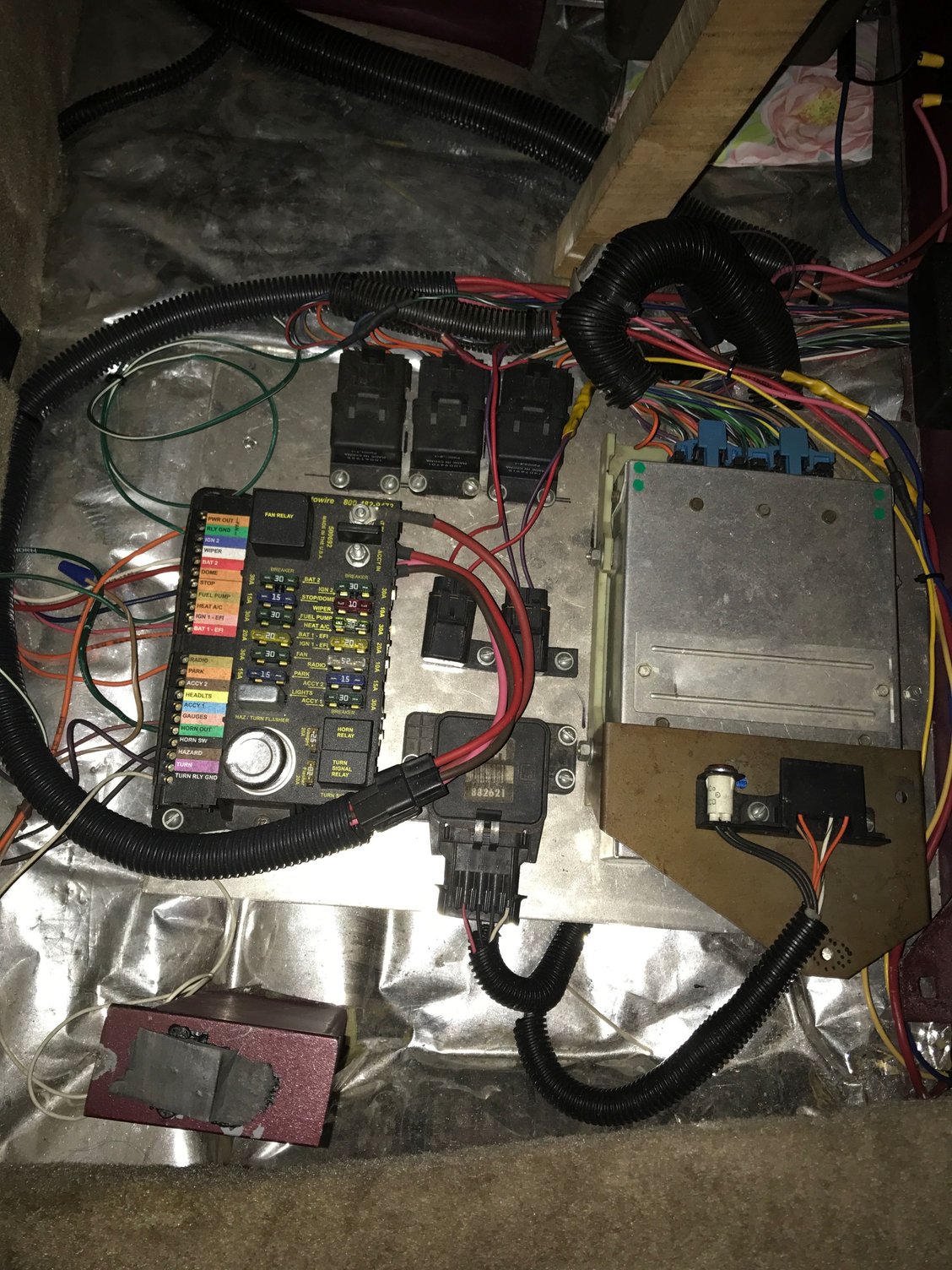

I really hope someone spots this that can help me. I know it's not a third gen but it's out of one. One of my customers just bought this 40 ford pickup with a TPI swap that never ran right. It ran very rich and and had a very high idle the firs time I worked on it. Found a slim spacer glued to the throttle bracket for a higher idle and removed it. Unplugged the 9th injector set the timing, cleaned the throttle body, replaced the o2 sensor and its running cleaner now. But it's idling around 700+ and goes in gear to hard, turn it down a little and it stalls way to easy. I really need help with what vin I can put into my scanner to tap into the computer in the morning to get some data out of it in the morning. We have never seen the truck run right and it looks like the PO put in a new IAC. Any suggestions or advice is very appreciated.

Being it has the 9th injector and appears to be a 1227165 ECM it's going to be from an 86 to 88 F body. Either the LB9 engine (305) or the L98 (350).
What is the engine? Is it built? If so it may need the chip tuned for the engine. Take the cover off the ECM and get a picture of the PROM chip.
If it has a radical camshaft, etc, then it will need tuning most likely to correct the idle issues.

The engine is supposed to be and a appears stock. Right down to the ceramic coated third gen exhaust manifolds. Even has a third gen exhaust system. He was told it was 86 350, but I went into my component testing with my newer scanner 5.7 was not an option. I've borrowed a older scanner this weekend to look at data but have no vin.

The only '86 350 as a standard option was in a Corvette. There are rumors that some late '86s may have had a 350, but those have never been well documented.
The AKFP PROM appears to be from a 1988 LB9 (305).
Once you connect and can read data, you may discover that the target idle RPM is 700. There are adders and modifiers depending upon conditions and inputs, of course. If you find that the target idle is lower and the IAC steps are very low, start looking for intake/inlet leaks, including the EGR and PCV. I do know that in some versions of the LB9/auto trans PROMs the target idle is around 700 RPM in PARK. Once the transmission selector is moved that target should drop to the "desired RPM in Drive" parameter.
Another thing which is not helping is that the air inlet is at about the hottest part of the engine compartment. As long as the IAT is in an acceptable range that may no matter a lot,but it is not optimal.
