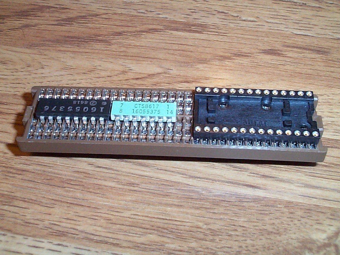

Is that calibration that chip mod from here?
http://tpiparts.net/inc/sdetail/11100/1495

The adapter is a moates.net g1
Not a bad deal programmed from tpi parts
http://www.moates.net/g1-memory-adap...-etc-p-32.html

I like the adapter, but its a little squirrely in my 16197427, and it makes me feel like it'll just come lose the next speed bump i hit.

I can vouch for the TPI PARTS Adapter: http://tpiparts.net/inc/sdetail/11100/1495
Solved my hard cold start problem on my '86, also got to finally change the fan on/off temps as well. Bought the over priced block off kit and have yet to install it, just unplugged the injecter until I have time to get in there to install it, Cars been running fine since April '17 as is..
but as Tuned Performance states: probally best to burn a chip to fit the slot in the long run..

Ok I got the chip thing from TPI Parts. The car had not been run since Monday. Last night (Thursday) I went out and installed the part. I disconnected the 9th injector like the instructions said.
All installed....car sat for 3 full days.....started on the first turn of the key. I wasn't sure this was the fix as it would sometimes start right up after sitting for a few days but when it always gives me problems is after sitting for only one night...and man it would take me almost 5 minutes to start almost killing the battery from running the starter so much.
So I just went out and started it....BANG! Started right up.
I'm still skeptical as there have been times when it just decided to start so I'll report back after a few more starts but I think this did the trick. If so it will have been the best 90 bucks I have ever spent. LOL

So my question, if the adapter works for you, why do I still have the hard start problems? I have the same adapter installed, the 9th injector is disconnected, it is even removed, have a block off there now
Re: Another hard cold start thread....but.....
But again.....I am not 100% sure yet that this is the magic fix. On very few occasions the car would start with no problem. So either this is the magic fix or I happen to get a couple of lucky successful cold starts right at the time I installed the adapter. I will update the thread as I gain more starts whether good or bad.
Started this morning as mentioned....started right up. That was at about 9am so roughly 10 hours ago. Typically after sitting 10 hours it would give me trouble. Again it started right up so I'm starting to be a believer in this PROM adapter.
Still starting nicely. Plus I installed a high torque mini starter. Has a much different sound.

I am starting to think the unit from TPI Parts was in fact the magic fix for my problem. This morning it's 50 degrees and I went out to start it after sitting overnight and she started right up.
No question in my mind on a cool morning like this I would have had to spend a good 5 minutes getting it started and nearly kill the battery in the process.
Ok I think I can conclude this thread with a final post.
The car starts fantastic every time! The PROM chip adapter is...for me....the magic fix and in more ways than the starting issue.
Today I drove it all day, I drove it on the highway and around down for hours straight, burned a good half tank of gas. It's not terribly hot today, temps are around 75 today so I was cruising with the windows down and AC off.
The car just runs smoother. Before when sitting at a light, car in gear and stopped...the engine would surge up and down by a hundred +/- RPM. That issue has vanished.
Also, the engine runs cooler. This may be due to the engine temp fan switch programming because it would get warm sitting in traffic. Never over heated but it would just creep right to the 220 mark. Now it won't make it past that half way tic mark between the 100 and 220 mark. So if the markings on the gauge are evenly spaced that would be about 160 degrees. I'm sure it will go a little higher on 90 degree days with the AC on. But comparing similar conditions....it's much cooler.
So anyway....very happy! Thanks for all the help guys!!
