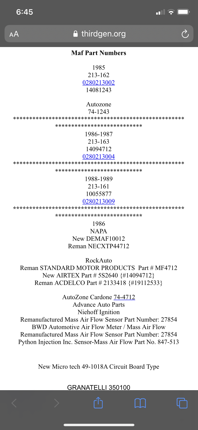

If you need specific MAF part numbers here they are:

Thanks yeah all the wiring is intact and California car so missing the humidity that normally destroys things. Very clean connectors and contact points, I replaced the wire looming and re-taped with 3M as the old stuff just crumbled. Thanks for sharing the MAF part numbers but I have renewed confidence in it since cleaning. Wish some other 1985 folks that would chime to confirm if this is normal behavior for this year.
