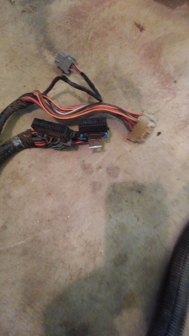

Originally Posted by Bobby Suth
i would like to. I have a 86 lb9 that. Was running fine when the engine was pulled for ls swap. My car is a 85 iroc. I see a o2 on driver's side that my harness didn't have connector for. That in the exhaust manifold right? So are there 2 of them. I'm going to look
l found the connector that Po tucked out of the way. They had done a 350 carb motor swap to it and I put it back stock. Not easy!😁 I dropped the ECM down and it's got a Bosch box piggy back on the mounting bracket. I've got the ECM that came with the engine. Oh btw car ran same with o2 connected.
the guy run this engine at the drag strip and road. No telling what it has in it without tarring into it.

Re: I want to do open loop
Found a harness in my parts shed. I think it is out of a 87 Camaro
