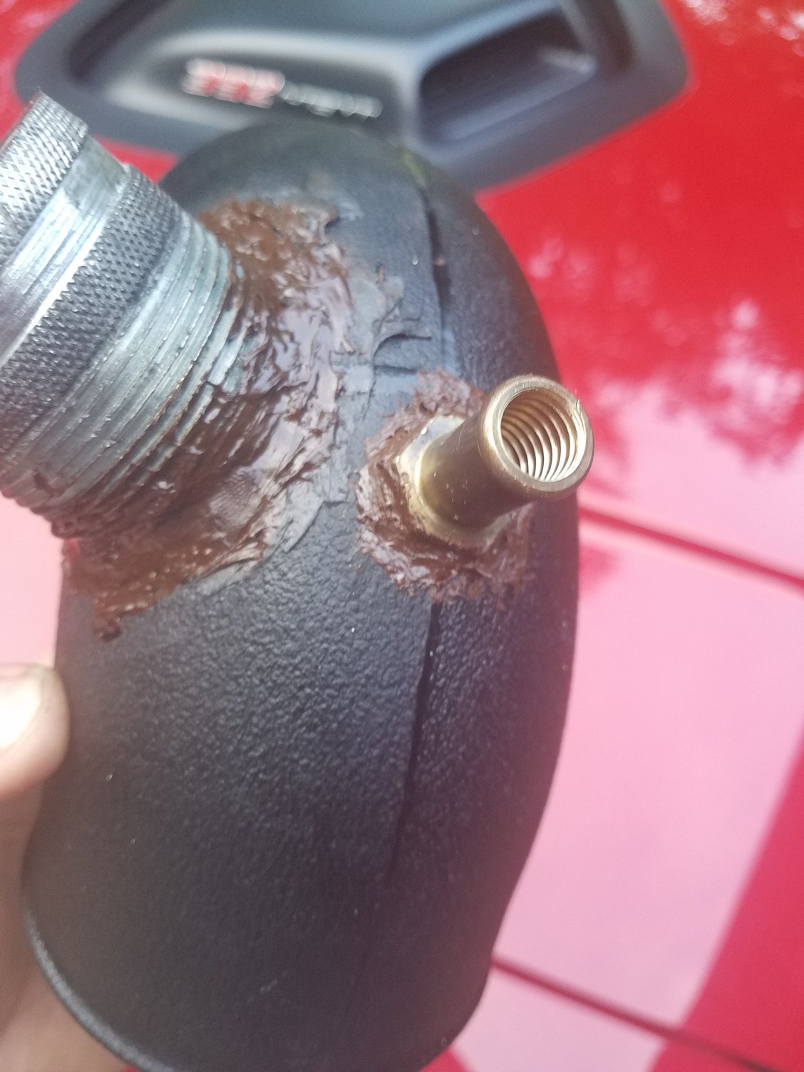

Also, on the supercharger elbow I found this:

Here is the intake tube leading to the supercharger... nothing was plugged into the port where the PCV is supposed to go as well.

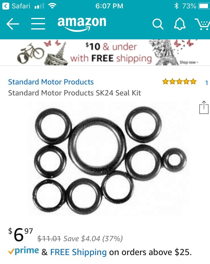

Fuel leak found on 9th injector tube.

Standard motors sk24 contains the fuel rail and ninth injector o-ring.

Re: Operation TPI Glory underway. Code 34 and Tuning

This is the intake elbow where the bypass valve and PCV enter in front of the supercharger. It looks suspect... yea. Well the kit is discontinued so no buying a new one. The fittings you see were already there. The pipe fell out and nothing was ever connected to the PCV. So, yep... goop it up with gasket maker, thread it back in and butter it around the edge. How *******, I know. I am not sure there is another option. So, I threaded the brass fitting inside and will put sealant on a bolt and install it. The PCV on my car still enters the manifold base as stock and since the PCV is a check valve should be fine under boost. Except that might be when in needs to vent most. Thoughts?

Cheaper from Autozone for Viton O-rings.

So now, it has a Code 36 and the idle problem. I put a new MAF burn off relay in just to be sure. The guy I bought it off of said he had replaced it, but it looked to me as though the power relay had been changed but not the burn off. It didn't fix it. 36 Still came back.
On the idle side, that is much better. As shown above, I found a fuel leak. Then while chasing it down I found that the connection to the blow off valve to the elbow was questionable and the PCV connection that is supposed to be used was left open and the PSV is still connected to the manifold in the factor connection. Well, without knowing all that was compromised, I had tried replacing the IAC and doing the reset/idle set procedure and it was just way off once the repairs were made. After allowing the ECM to reset the IAC , dialing back the set screw and bumping it up until the IAC was where I wanted it, and then adjusting the TPS to the proper volatage... idle was solid cold and warm. Let's hope that stays.
I did log data, but realized all my USBs are here at work going to try to remember to take one home tonight so I can get the file off the old laptop and post it up here.
