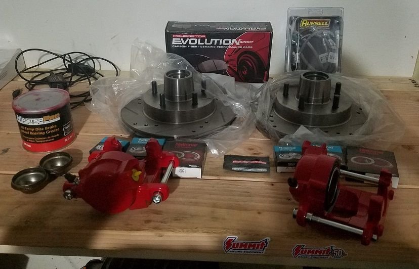

Front components are here:

Bearings didn’t come in that kit did they? My front end is apart right now and I’m thinking I might just replace lines and bearings and throw the old stuff back on for now. Too much else going on and I can do the brakes any time.

I could be wrong, and please do correct me if I am, but those look like stock calipers to me. I doubt they'll add any additional braking force. But, depending on the price you paid, it's probably a decent stock replacement unit that comes powder coated. I can only assume that any additional braking force that might happen would be from replacing the worn out rubber lines with braided steel lines, the additional initial bite from the slotted and drilled rotors, new brake hardware\fresh grease, and perhaps upgraded brake pad compounds.

100% correct. If you follow the thread above, I do not plan on road racing or auto crossing this car. The cost to go to a bigger brake system just isn't justified based off the intended use. The brakes calipers themselves will not have more force, but the better rotors/pads it will use the force more efficiently with he addition of the stainless lines. I don't expect huge improvements from a fresh stock set up, but the cost to upgrade was very minimal.
No the bearings did not come in the kit, they are Federal Mogul and were purchased separately.

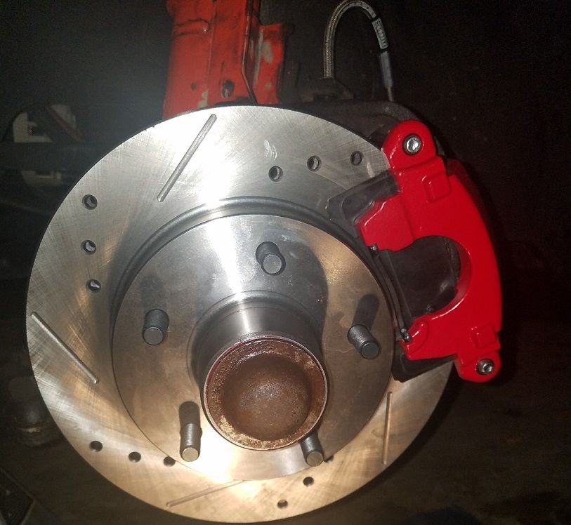

Fronts are done with new hoses. I will tell you, the small investment I made on a vacuum brake bleeder that works of my compressor was worth every penny.
Broke them in by the prescribed way and all pulling issues are gone. Brakes hard and straight. Now the rest of the rear stuff just needs to get here.
I can't really compare these to stock as it has been too long since I drove one that wasn't compromised. Also, the fronts have their braided hoses, but the rear still has rubber. Pedal feeling is better, but still isn't what I would like to have. It is much better than where I started, but where I started was not 100% up to factory performance.
