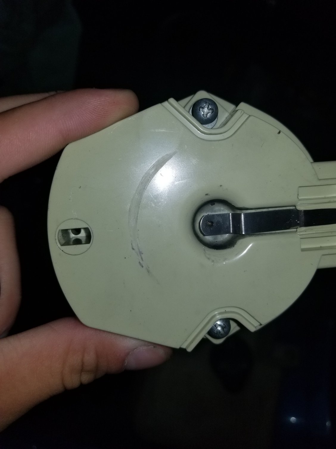

I am getting a code 42, I removed the cap to find my rotor and cap both damaged and the top of the shaft where the rotor screws in to is bent, I am going to replace all 3 but I am not sure what one to get, the only distributor that I can find online that fits is one that is meant for a 305 TPI not a 5.7 TPI. My current ICM is also a 7 pin ICM and the only distributors that have a 7 pin are for the 305 TPI also, are they interchangable?

I found that ICM but I am replacing my entire distributor and I'm curious if one from a 305 tpi will work in my 5.7L tpi
There is no reason for it to not work. GM originally may have used a different ICM, just to reduce the 305 engines power. But other then that, no difference. Look up one for the same MY but for a Corvette. They only came with a 5.7l engine. And again, should be a drop in.

So the one pictured above I shouldn't get? That's the one that is currently in my car
OK, why is it you shouldn't get it? It states Delco Remy. Not sure if that is GM or not. Is this the distributor that is causing code 42? If so then maybe there is an issue with it?

I'm not sure what is causing the code 42, the distributor in the picture is the one I currently have now so I will just buy the same one and swap out the old one. ECM is brand new, ICM is tested and good, so I'm just going to replace the distributor, cap and rotor and re time the car and hope that fixes my issue. The top of the shaft where to rotor screws in is bent and it damaged me cap and rotor
