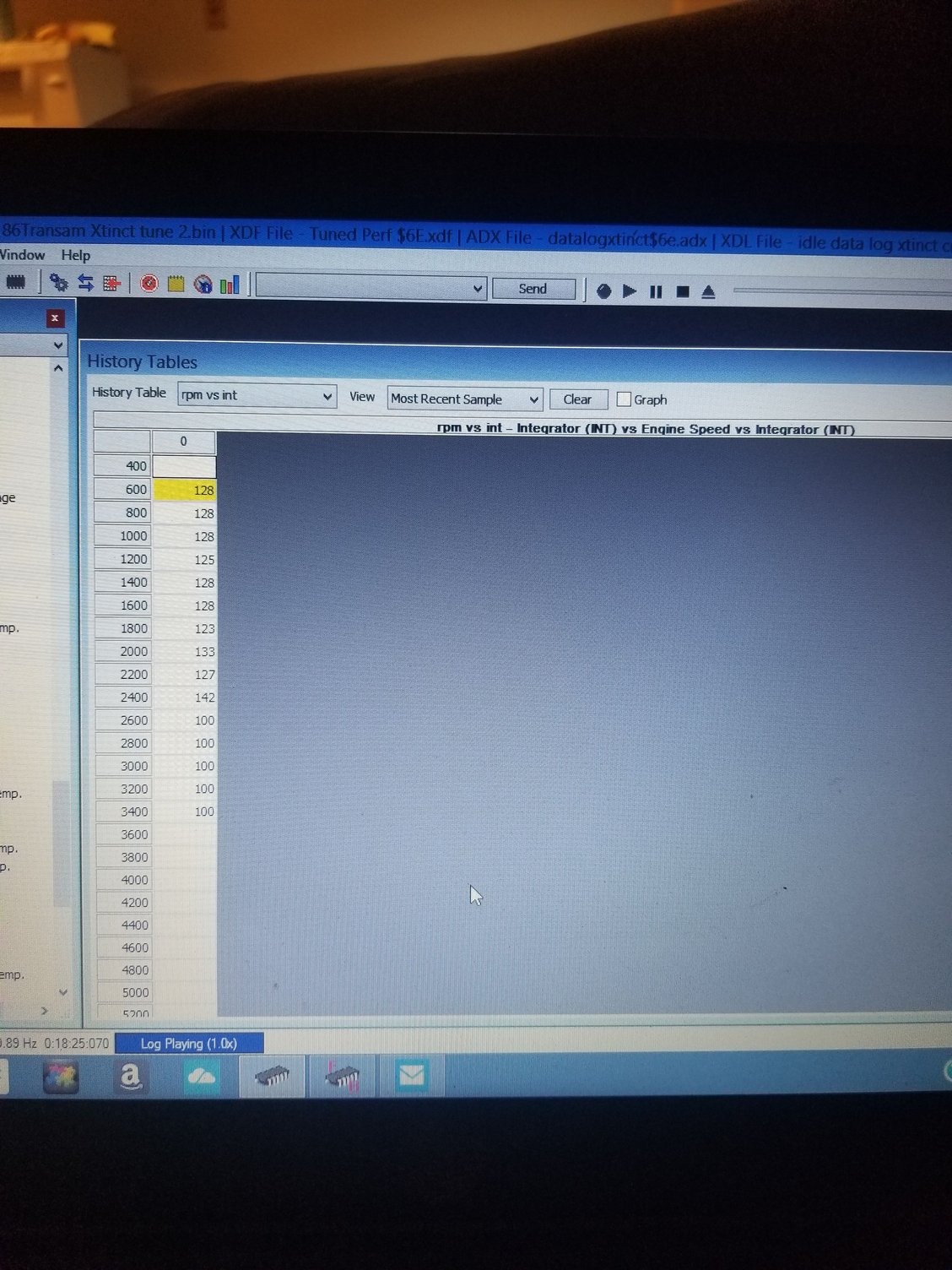

I will data log the car in the morning on the way to work and take a picture of it for you.

I logged the car this morning, this is average. I am like 10-15 miles away from work.

I logged it at lunch.. . It is average again.
