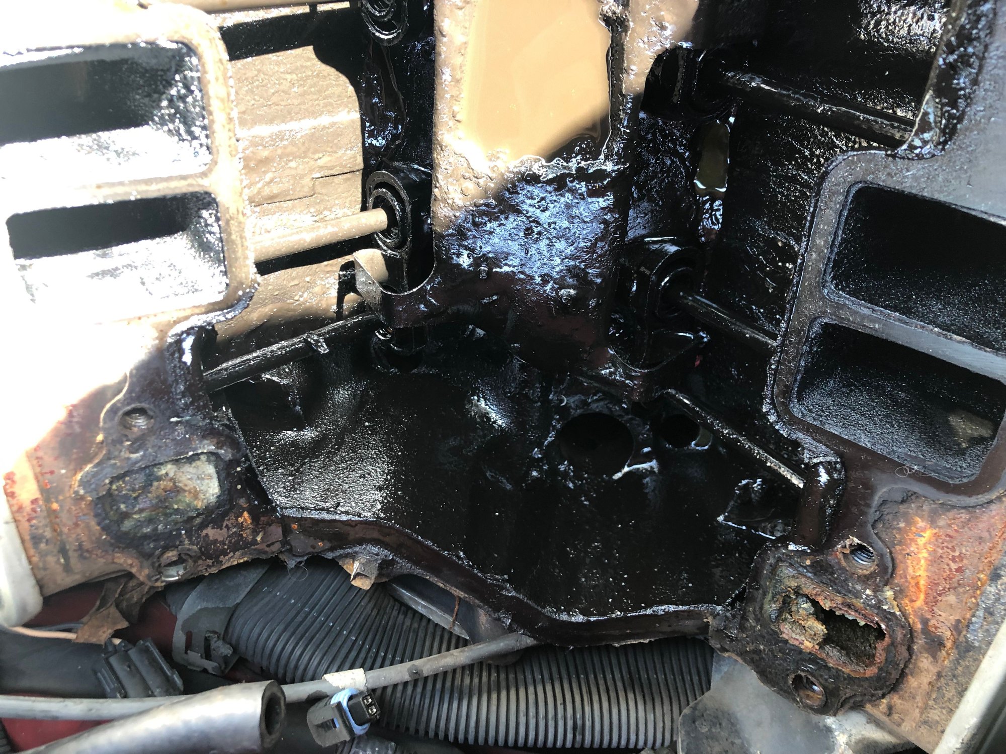

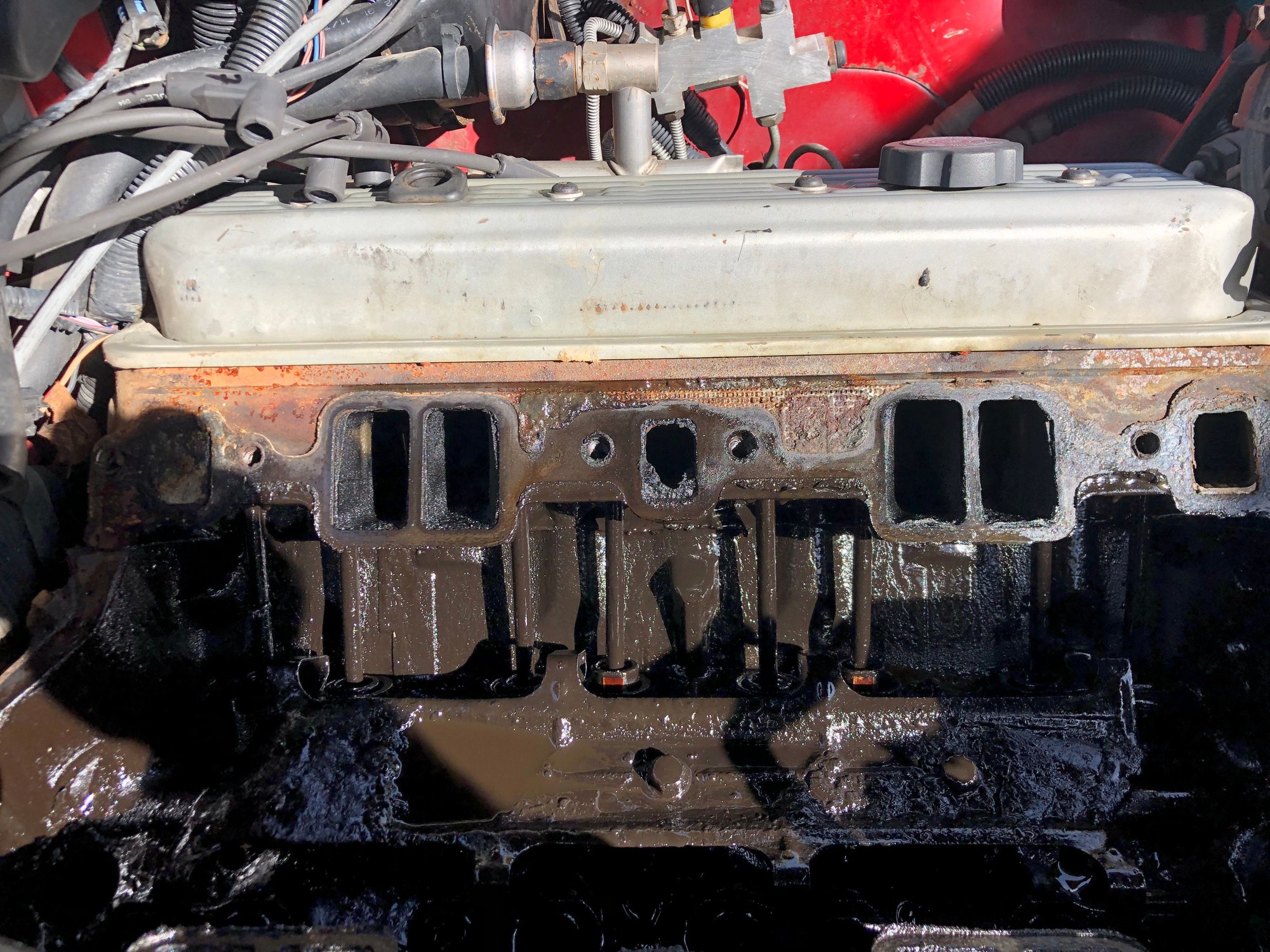

My 91 trans Am Convertible 305 TPI has sludge in the valley....!!!
engine still in the car..... removed intake to fix coolant leak.....
this is what I found.......
best way to clean with out pulling the engine....??
thank you

Can I “fill the engine with diesel fuel and let sit then drain....??
need help with this....

I would wipe out as much as you can with a rag, then buy several cans of brake parts cleaner from Walmart and spray it all over. After that drain the oil, refill with a cheap Walmart engine oil and add an oil flush agent. Put the top of the engine back together and run it to let the flush clean the engine some more, then drain the oil again and put in mobile 1.
That's a LOT of sludge...

I would do what was suggested above. That is alot of sludge. I would be worried about the oil pump pick up getting clogged. How was your oil pressure before the tear down?

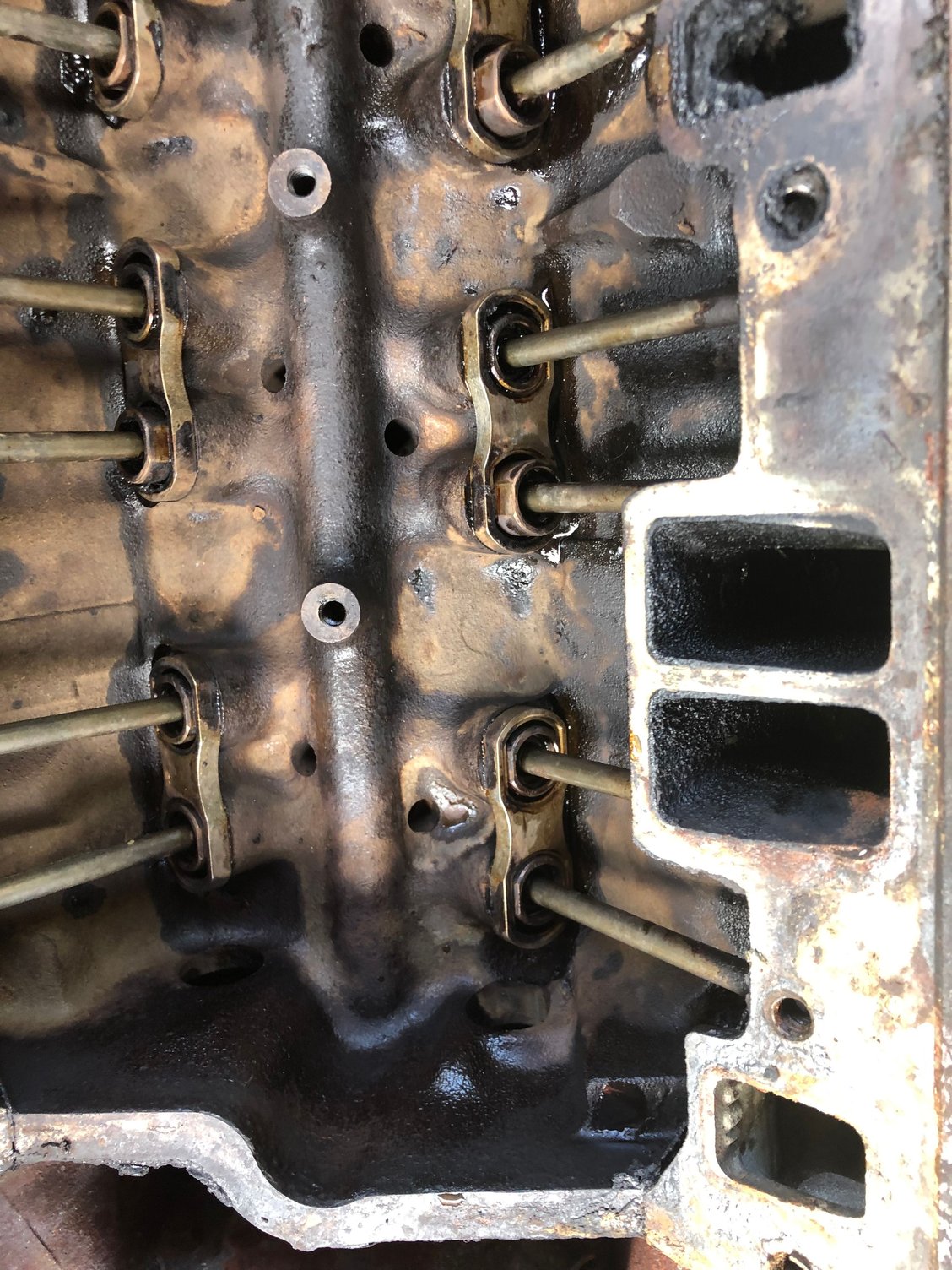

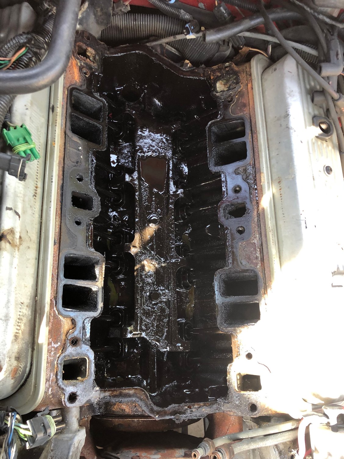

Ok I scraped and carb cleaned it.....

Before I drain the old oil out.... should I clean it more....??

Looks worlds better, but whatever you do don’t forget to reinstall that retainer for the lifter guides!

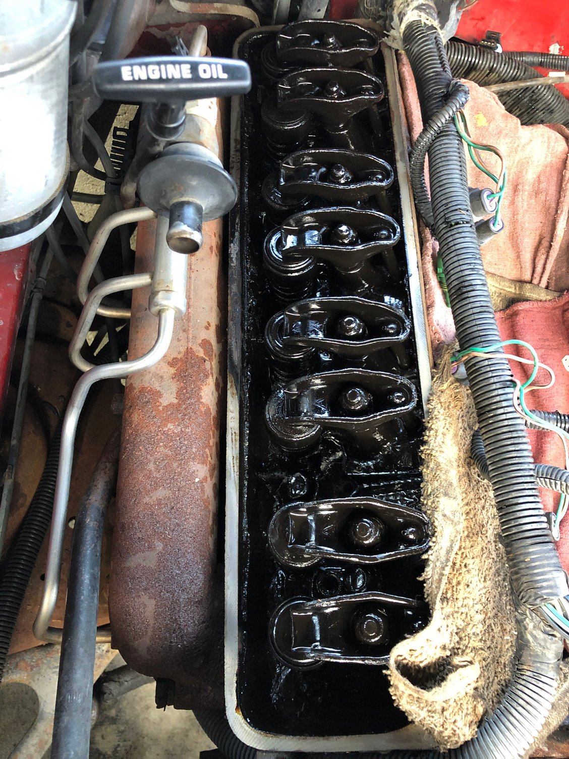

Took it off to better clean it and the valley....

What can I do for the ports in the heads.......??
Nothing; any attempt to clean any of that stuff out of the ports will send it into the cylinders. Stuff some balled-up rags or paper towels into the intake ports so you can clean off the gasket surfaces without scraps getting into the engine.
Are you going to drop the pan and clean it and the oil pump pickup? If you don't, all the 'stuff' that's been washed down from above is liable to wreak havoc on the moving parts. Seriously, trying to clean out a sludged engine without complete removal/disassembly leaves you between a rock and a hard place; what's left in there is going to get circulated with the engine oil.

Like Drew and others mentioned without pulling and disassembling the engine your options are kinda limited. What you’ve done so far looks good but every cover you could pull will probably result in the same find. I’d say finish up what you’ve done, put it back together and run some engine flush through it a time or two with fresh oil. Follow the instructions and let it get good and warm. It will tell you to let it idle but you may be able to induce a little RPM, just don’t rev it like crazy. Get some temp in it and then drain it as soon as possible while warm, and just let it drain and drain until not even a drip is coming from drain plug. Do that a time or two and finish with fresh oil and filter, you should be just fine

Looking way better. I couldn't even see the spider before.
Yes, you can use diesel fuel to flush all of that crap out of there. I did it to mine. Buy 2 gallons.
I would put the valve covers back on with the new gaskets and fill through each cover.
Catch the diesel coming out of the oil drain plug, strain it, and repeat multiple times until no chunks come out.
The last time I would let the 2 gallons sit in the engine overnight. After the final drain, let it "dry" for a while.
If you have an air compressor, use it to help blow out the rest and help with the "drying".
Then do the cheap Walmart oil procedure as others have suggested. Add Marvel Mystery Oil to help continue the cleaning.
