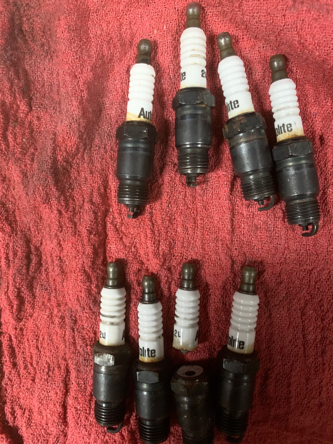

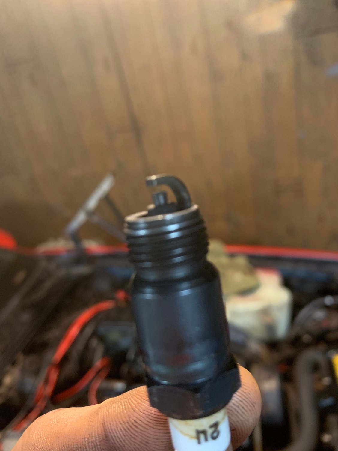

Pulled plug #1 wet with fuel. Pulled the rest. All wet with fuel. Cleaned dried and here they are.broken one is from cylinder #6.
