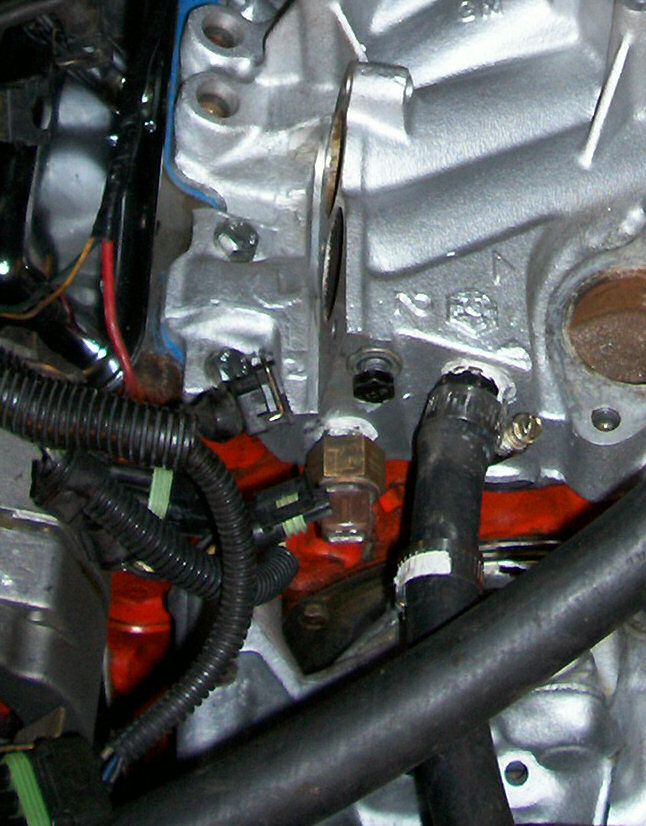

Two coolant sensors on the TPI manifold?
Getting ready to put the L98 in and buttoning up a few last things. My old 89 LB9 TPI manifold had only one port on the front of the manifold for a coolant sensor. The one from the 88 L98 going in has two. Can I just plug one?

I think that other hole was for the cold start injector switch, if you're not using it, then just plug it
Yep that is correct.

Bringing up an old thread... Well, sort of old. I have a similar question about the sensors on the front of the TPI intake. It makes sense that one is a "switch" for the cold start injector but I'm curious which on is which. I have one with a plug that looks like an "injector" connection so going to make an assumption that is the one but could someone please confirm. The other sensor has a traditional "GM weatherpack" connection and clip .
Thanks

If it doesn't look like the sensor in the first post it should be the cold start switch

Thanks scooter... That's the one I assumed was the cold start switch.

You're right about the connector. The cold start control used the same RP connector as the injectors.

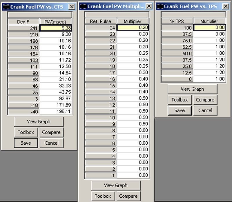

Now 19 year more wise, or the opposite, I'm trying to reduce the "rats nest" under the hood so among other things I'm going to remove the Cold Start Injector and just tune for it's operation during cold cranking. I did a quick search but couldn't find a solid answer, does anyone know the coolant temperature at which the Cold Start injector was commanded to fire during cracking?
Merry Christmas...
Old Dec 24, 2020 | 09:35 AM
Vader's Avatar
Posts: 19,658
Likes: 310
Re: Two coolant sensors on the TPI manifold?
In previous conversions I have set the parameters as follows:
There is also a Startup spark advance vs. CTS which can be tweaked to optimize cold start, but you'll need a cold chamber to test that out or wait until January along Erie.
